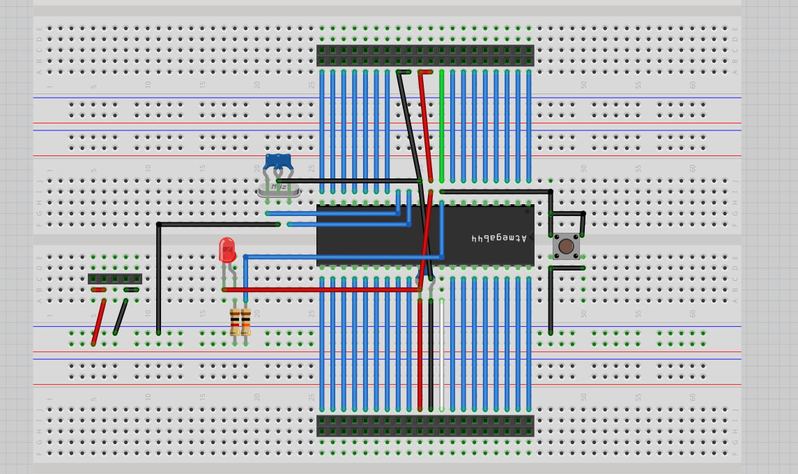

i use arduino as isp, that work with other cips; schematics are uploaded below
mi question witch one is ded ??

the connections are fine because i have other cip and everything work just fine
is not on breadboard ... everything is fixed no lose wires

Your fritzing wiring is not complete. It is missing GND connections, and power & Gnd are not shown coming in. Reset switch might need turning 90 degrees, use a multimeter & confirm what is open & connected on it.

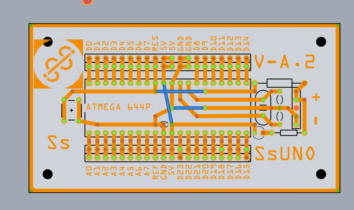

Your board is hosed - looks like that would be the view looking thru the board to the bottom of the chip?
