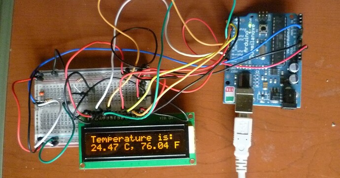

Regarding the temperature sensor, my understanding is they're also referred to as 10K Thermistor, so that includes the thermistor itself coupled with 10k ohm resistor. I'm learning as I go, so does that sound like a good explanation of the sensor specs?:
iLearn:
No, I think it means a thermistor with a resistance of 10K at 25C. You would need to add another (fixed) resistor (e.g. 10K) to form a voltage divider with it.
iLearn:
Arduino Your Home & Environment: The $2 Thermistor Temperature Sensor
Yes perhaps it does.
Looking at this picture from the link you posted, its clear the sensor has only two connectors. That tells me that your theory about a combined thermistor and 10K resistor probably isn't correct. You would need 3 connectors for that. The thermistor and 10K resistor would form a voltage divider and therefore need connectors for +V, 0V and the output that varies with temp.
With only two connectors, my guess would be that this is a simple thermistor with a resistance of 10K at 25C.
