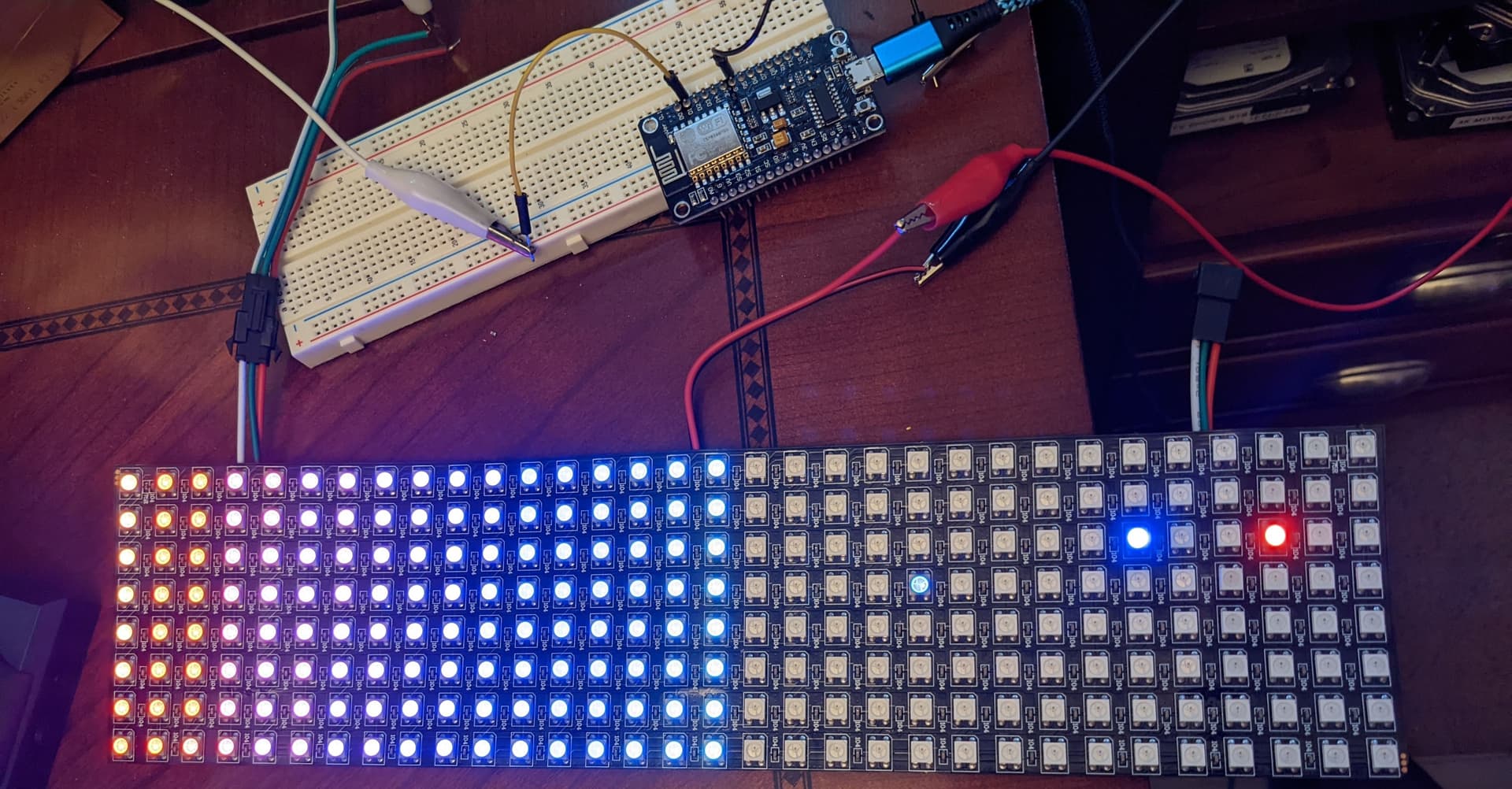

32*8 RGB Display, 17 rows working, the rest are not
I downloaded some sample code to display some scrolling text. The first 17 rows are lighting up, the rest don't work. I'm wondering if I am not setting this up correctly:

Video of the issue:
I am using a ESP8266 board.

My first guess is a break in the data line. Examine the traces between the 17th and 18th columns. Use a magnifier. Use a microscope if you have one.
Those are columns, not rows…

How is this powered?
External power supply, 10Amps. I have the ground going to the matrix and the 8266. Positive is just to the matrix.

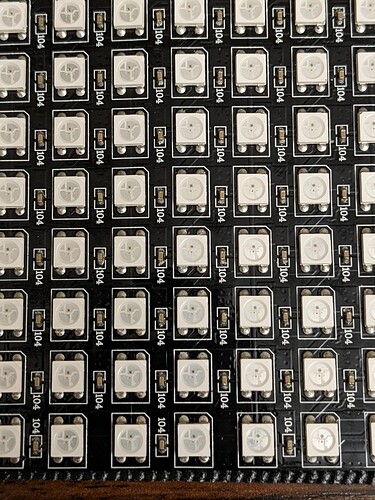

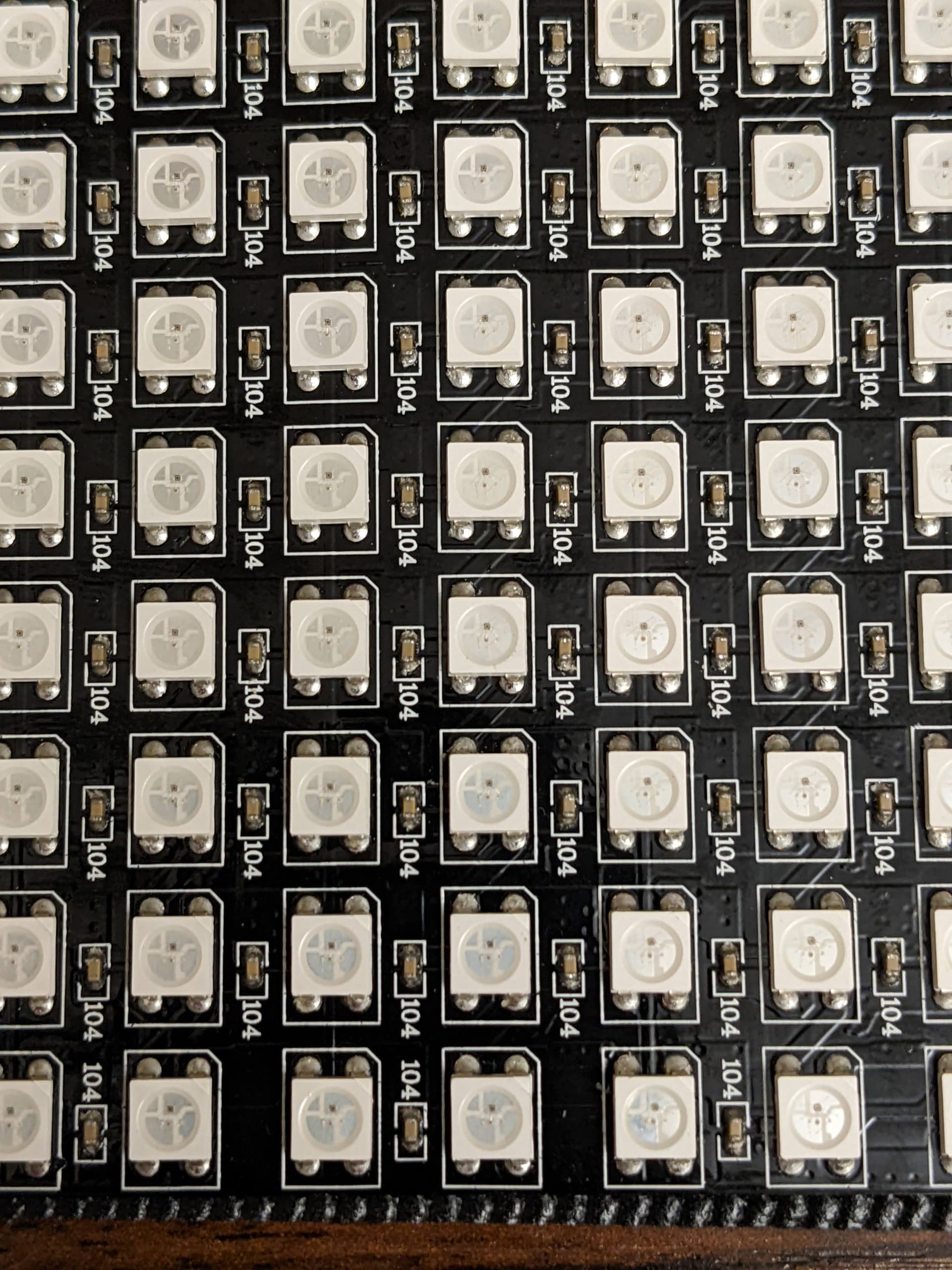

Can you please show us the back of the array?
PS. You have got the 470R or 330R fitted in series with the data line from the controller pin?
Here are a couple photos of the matrix. It was preassembled, I did verify the LED's are all in the same direction. I put 2 volts on the DIN line and traced back to every 104 cap and read the 2 volts. I also traced all positive and negative lines to the LED's.

Is it me or are there really 16 rows working?
So maybe exactly half works, an addressing issue or broken 2nd half &c.
a7
Starting with 1, it's 17 working.
Interesting discovery. I was powering it from the cable on the rights side with the D-IN. I moved the power to the center cable and 3 random LED's light up on the other side.
Can you power it from both sides ?
I tried that, no better. It must be a bad solder joint. Would a defective LED cause the rest of them to not work?
They're all daisy-chained, DOUT to DIN.
If there is a break then all that follow are out of play.
Perhaps a lack of continuity between "63" and "64".
Or one of those LEDs has a bad DOUT or DIN.

I looked up when I bought this on Amazon and it was still within the return window. I ordered a 2nd display this past Saturday and it arrived today. The new display works perfectly. I didn't want to mess it with anymore and possibly risk my chance of returning it for a refund. So it's all boxed up and will be brought to UPS tomorrow.
I want to thank everyone for their insights, this broken display helped me understand better how it works. So all in all it was a good learning step.
