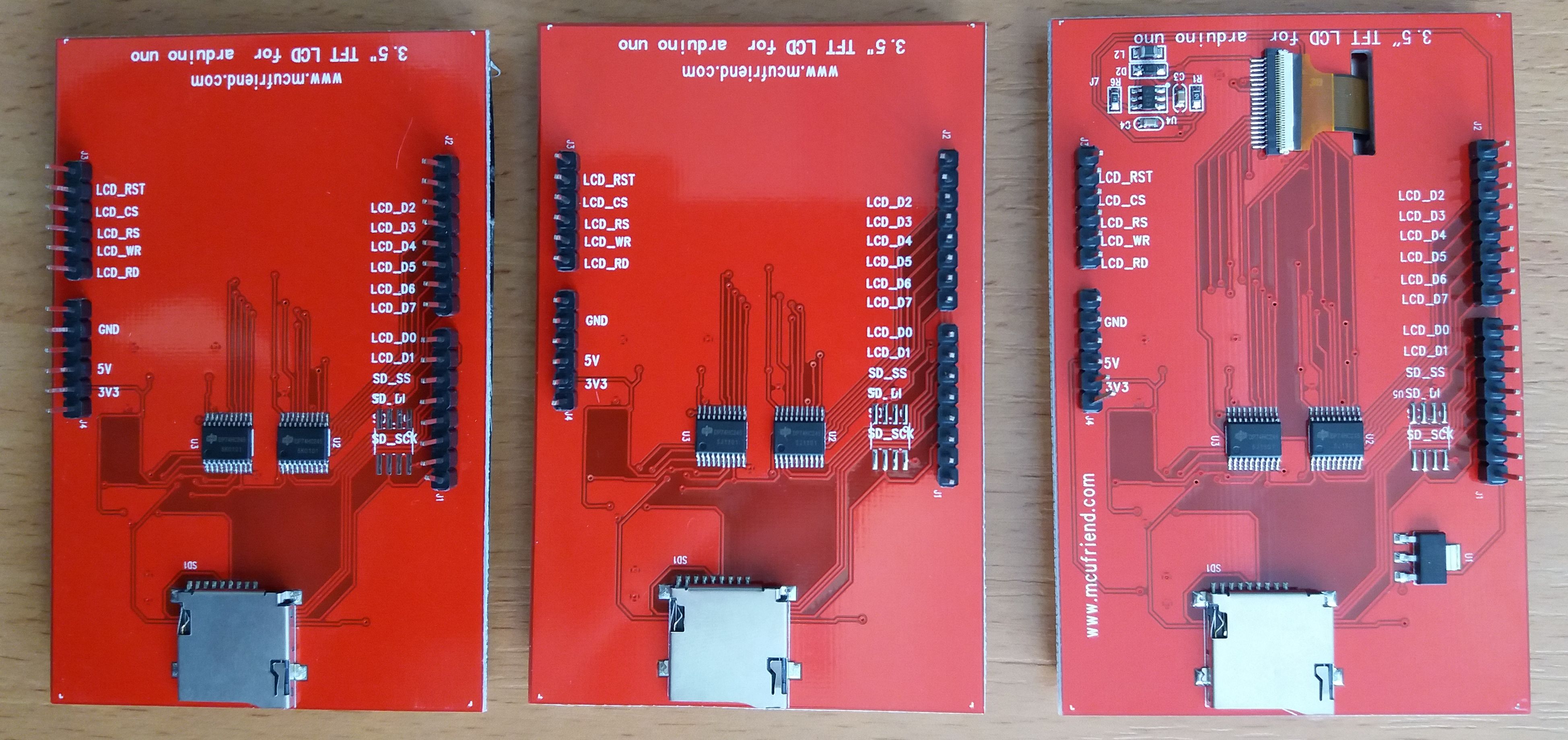

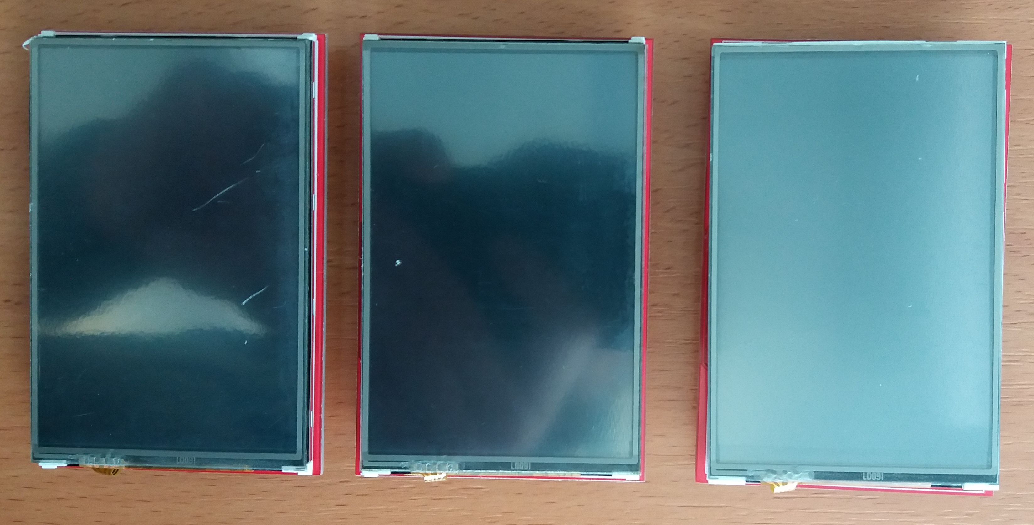

3x mcufriend 3.6 tft find difference :)
Hello guys, I just bought 3x mcufriend 3.6 tft displays from ebay from one seller. They should be the same but as you can see one is different :o Maybe you know what is different with this tft ?
Im still waiting for my arduino uno, when I get it I will check tft chipset.
For a start, the displays are 3.5" and not 3.6"
They "look" as if they will be 320x480.
The 3.6" displays are normally 240x400. i.e. long and narrow.
I do not see any 3.3V regulator on the two left hand displays. The 3.3V regulator on a UNO is not capable of supplying the 200mA backlight.
Most shields are supported by the MCUFRIEND_kbv library. It should report the ID.
If not, run the LCD_ID_readreg.ino sketch. Copy-paste the Serial Terminal and post it in a message.
David.

You are right I measured displays and they are 8.8 cm which is about 3.5".
I check IDs and the one with regulator is 0xD3D3 (when running tests picture is inverted with colors and position mirrored) and the other two are 0x0 (displays only white screen) hmmm this is strange, I'm pasting you LCD_ID_readreg.ino sketch Serial printout

After a while I got ID=1520 with other one displays but still white screen.
You have a Renesas R61581. It should work with tft.begin(0x9481).
You need to download the library from GitHub to use the 0x1520 controller.
Or just try with 0x9481.
Please let me know the results.

Ok ! finally i got my Arduino Unos. I uploaded graphictest_kbv with tft.begin(0xD3D3) and tft.begin(0x9481). Both displays work with 0x9481 but image is kind of flipped and colors are different(shows blue but it says red - the one with 3V3 regulator).
I will try both displays with the library you are talking about but could you help me find it ? Is it the AdaFruit GitHub or other or maybe you have a link for that ?
Thanks in advance david_prentice !

Ah, you are talking about your GitHub ok, I will check this lcds with your code after latest commit and let you know, thank you !
wow, you are great ! 0xD3D3 now has changed to 0x8357 and works as it is supposed to !
0x1520 has changed to 0x1581 and background is still white not black and letters are mirrored.

In which case, my last commit was unnecessary. There was no need to invert the colours (REV_SCREEN attribute) or to swap the horiz direction (INVERT_SS)
Force begin(0x9481) instead of begin(0x1581).
David.
Earlier I was using your library from forum thread, now I found your GitHub and now I'm using latest version. That is why those id's changed.
I tried to force begin 0x9481 instead of 0x1581, now background is black but some colors still remain inverted as well as text is flipped.

I updated the library this morning.
It should detect R61581 automatically with readID() (0x1581)
It should run all the sketches fine.
If you have a problem, please post video or describe accurately in text.
David.
You are right, it works like a charm after the update. Thank you very much for your perfect support !
