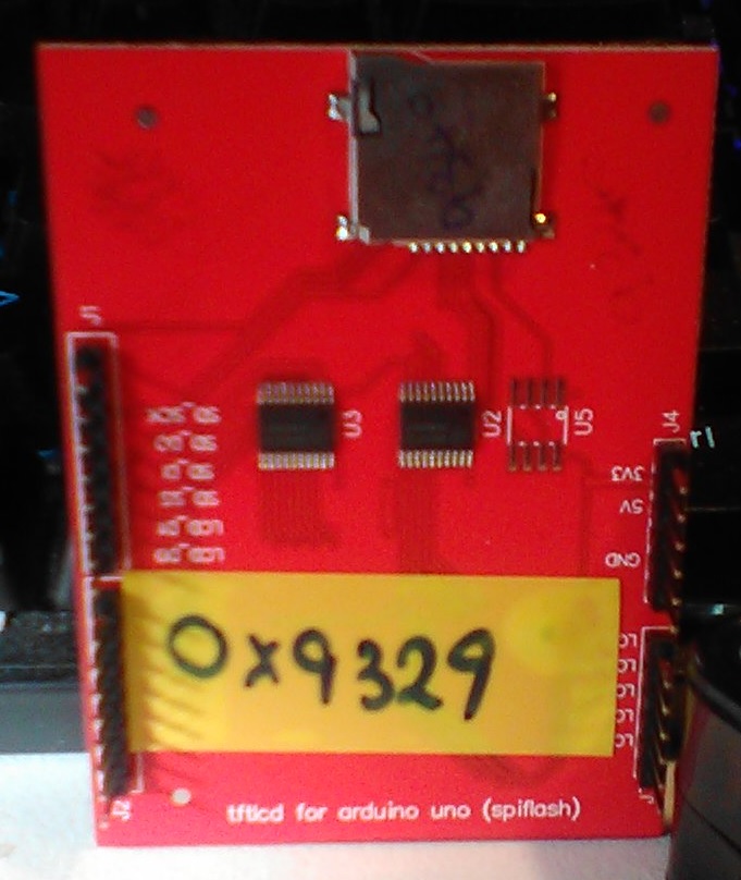

I have the same display;
Running the kbv graphic tester, I have found that the ID for mine is 0x9329.
The ID read by the program is not the correct ID.
Here is the testpattern code with the ID edited, so it should run.

For reference, this is the back of the display;
The two display drivers are SM245TS.
Sorry not the drivers..
Tom... :grinning: :coffee: :coffee: :coffee: :coffee: :australia:

You have an Ilitek ILI9340 Controller.
Please install MCUFRIEND_kbv via the IDE Lrary Manager
I suggest that you remove any library installed from elsewhere.
Now that I know you have an ILI9340 I can try your pasted code on an ILI9340 Shield. I am sure that I will get the same result as you. But it would fail on a different controller
David.
