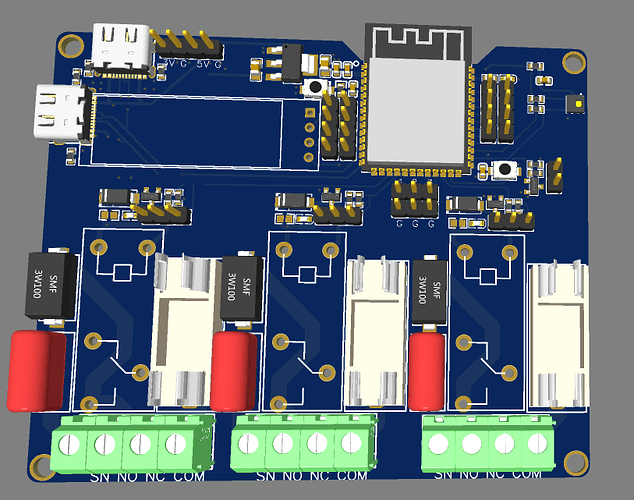

4 Questions about making an ESP32 relay switch with snubber circuit
Yes. In your case, since you have the snubber across the load, if the relay closes and the capacitor of your snubber is somehow shorted, you'll put HV-AC across the snubber resistor making it go up in flames.

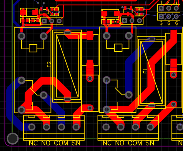

Should I use the fuse like on the left of the schematic and gerberview (in case the snubber fails) or like on the right (general protection of the com port)?
I did implement those components:

The 100 ohm resistor and 0.1uF 630V polypropylene capacitor snubber is intended for use across the relay contacts not across the load
The fuse is not jut to protect against snubber failure. The failure modes are far more diverse. So the one on the left is not appropriate.

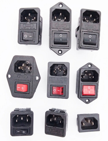

Frankly, in a case like this I'd maybe just use a fuse holder mounted in the housing of the project on the incoming AC line (either L or N). On AC projects I usually simply use a net entry part with a combined AC entry, AC mains switch and fuse holder integrated into the same part. There are many variants; e.g.:
All but two of the ones pictured have a fuse holder integrated into it.

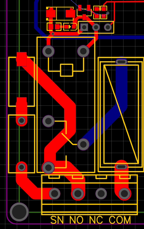

I connected it like in the right side of the schematic and rearranged the components (put the snubber on the left of the relay and the furse on the right). Also I disconnected the NC pin since it probably wont be used, but still left a 4 pin connector to have the opportunity to solder a cable on the back of the pcb.
Then feed your AC into the PCB and fork it off to each relay. That way you have a common entry point for your fuse and you don't have to fuse each relay separately. Your board will be a bit bigger to accommodate the HV-AC traces.
Since you have a net entry somewhere anyway, you can save the board space and go with one of the connectors I suggested.
I've done both depending on the project; it can work either way. Whichever you prefer.
If you absolutely must fuse every relay separately, by all means do that, just make sure that wherever you place the fuse it's actually effective.
Sorry, since you were using the 100 ohm and 0.1uf cap I though you decided to go with the snubber across the contacts. It's a tried and true solution that works in most cases.
I have no recommendations for a snubber across the load but I don't recommend using that cap for an across the mains application.
I just cloned the project and tried both versions and I think I stick with the fuses for every relay. I like the look of it :slight_smile:

  • I finished the PCB and did not soldered the snubber at the beginning
  • Even with the high quality and more expencive finder relays, it did not even take a week until they got stuck too and the TV and Soundsystem did not turn off anymore
  • A very bright arc was visible through the transparent relay
  • I then soldered the snubber and since then it works perfectly fine!
  • there is still a visible arc but it is MUCH dimmer, not so bright and strong
