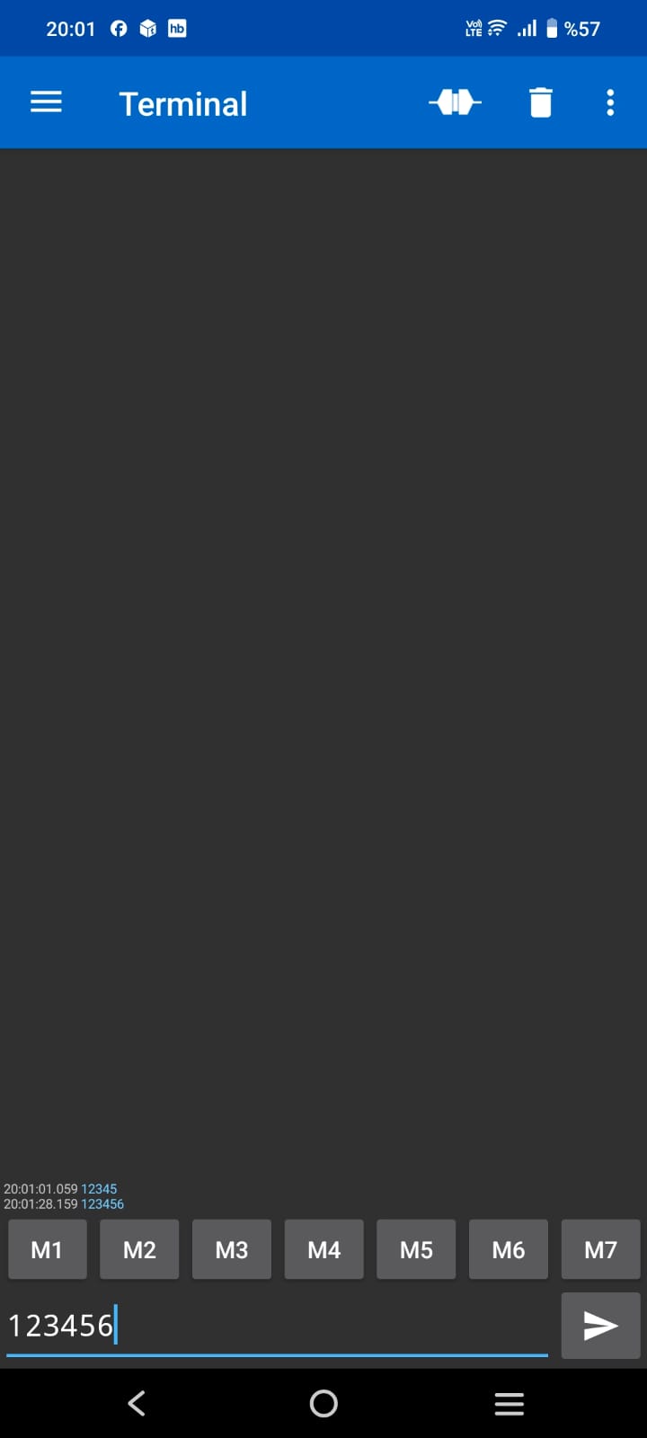

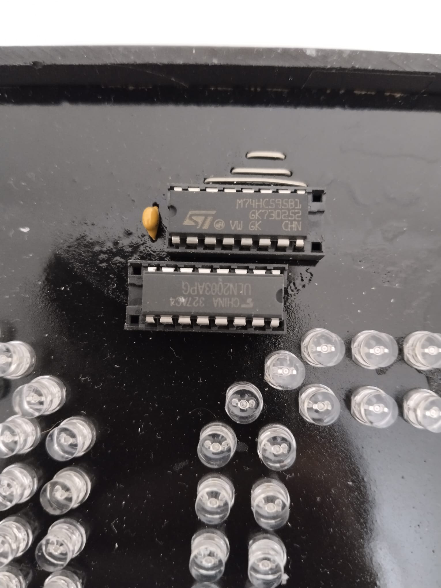

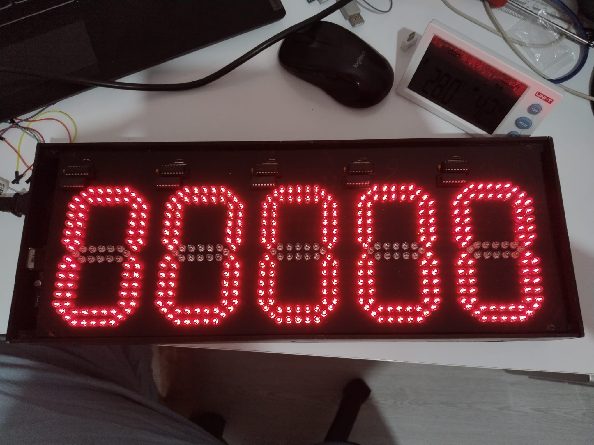

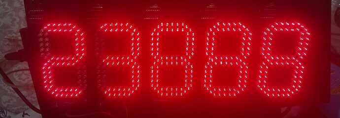

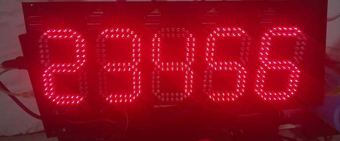

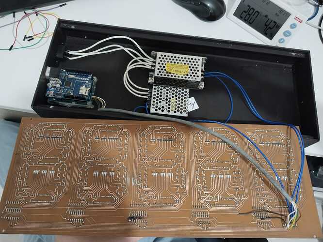

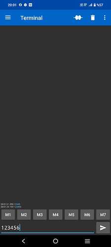

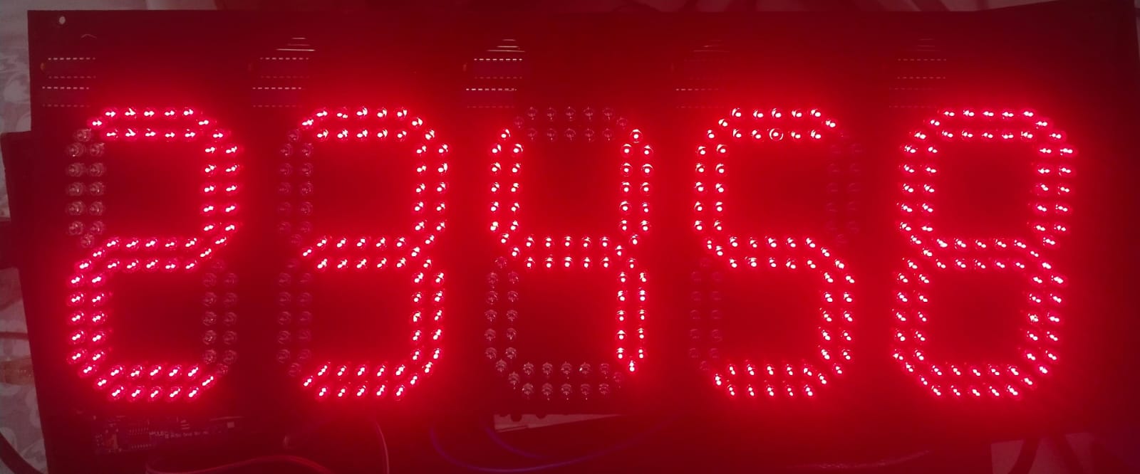

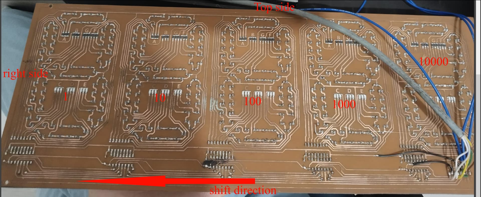

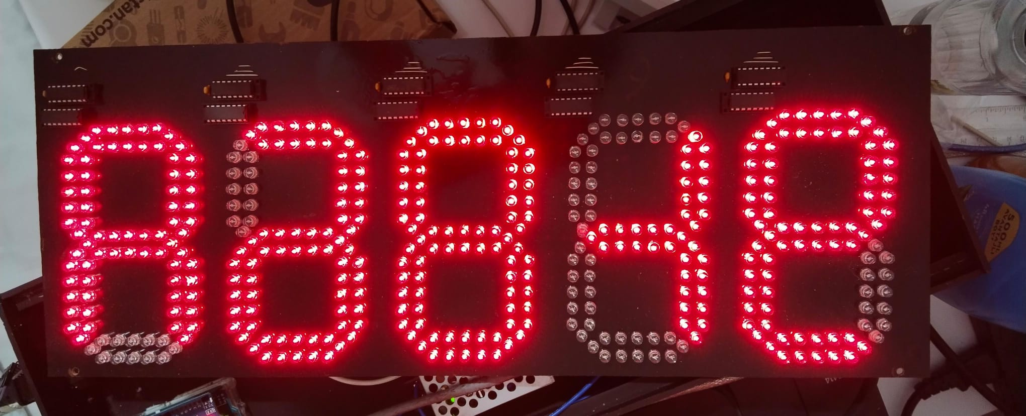

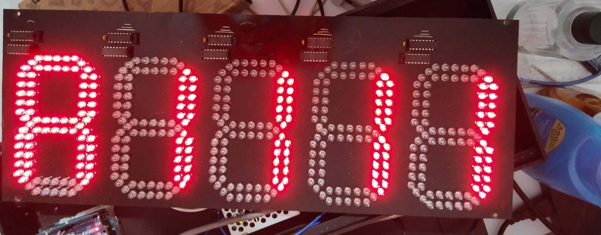

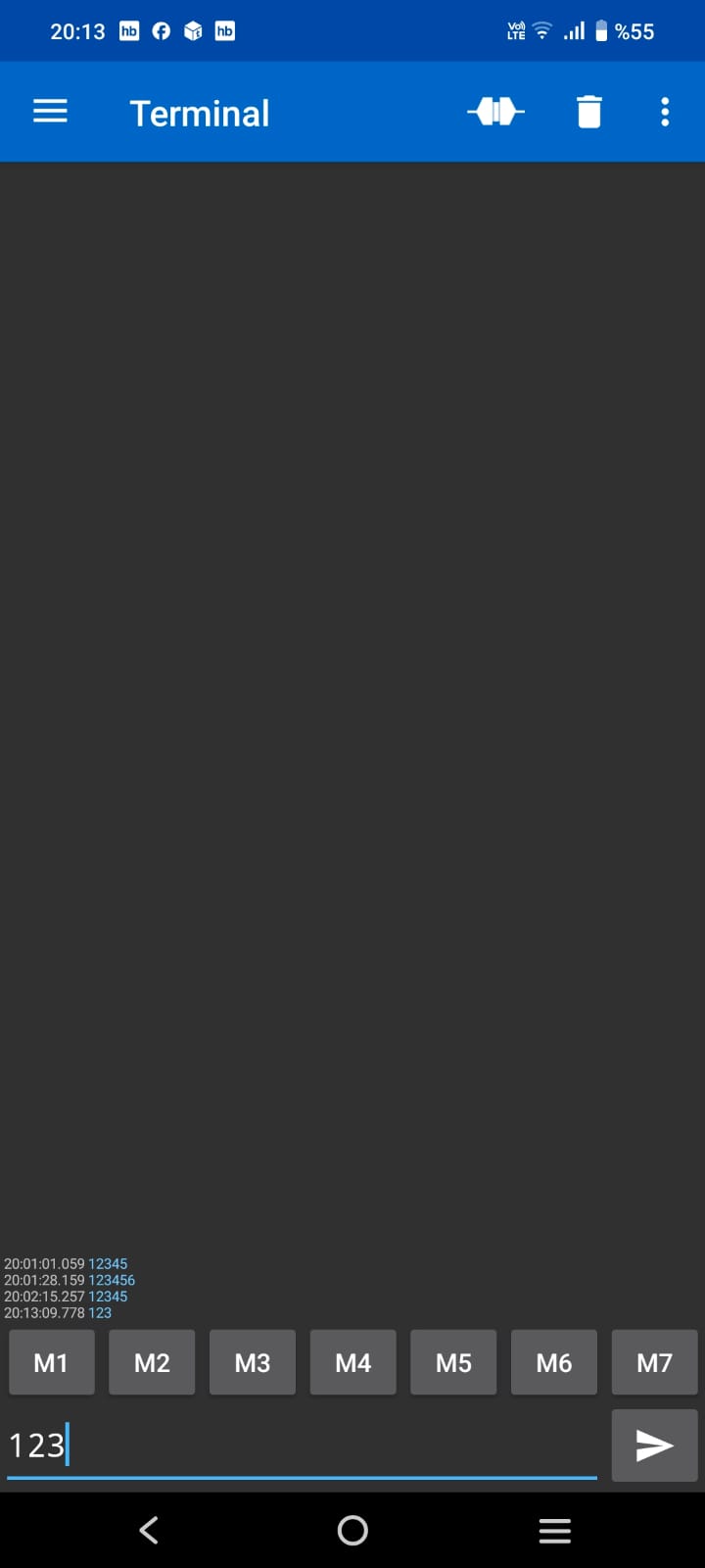

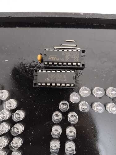

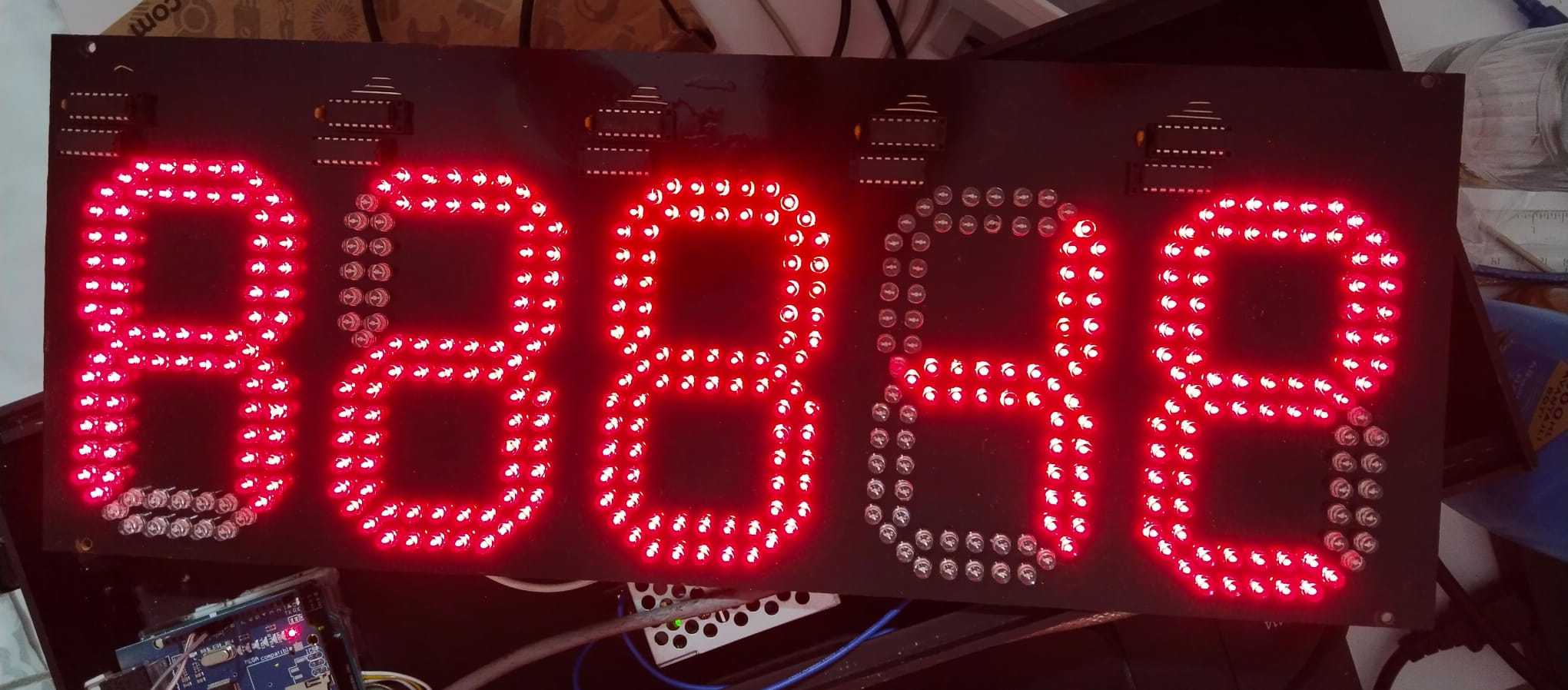

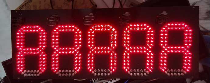

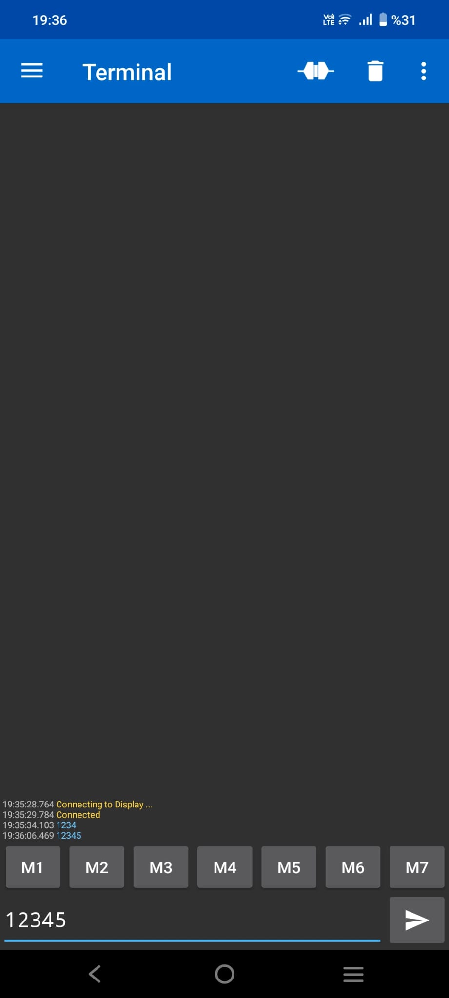

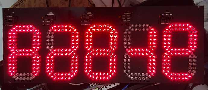

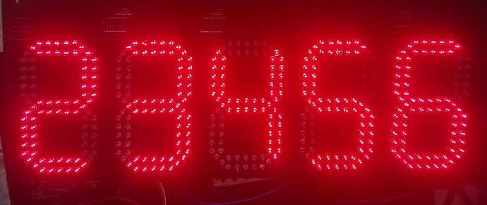

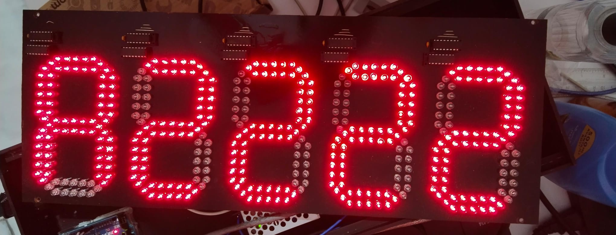

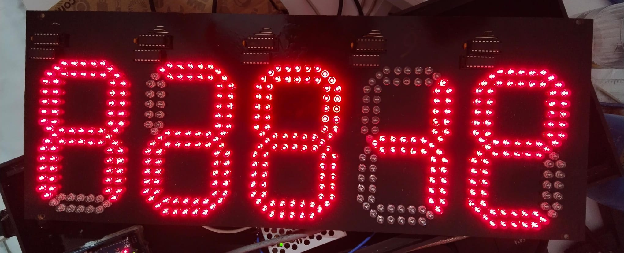

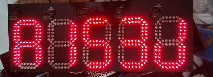

Good day, the first digit of the number I sent to the 5 Digit 7-Segment Display via Bluetooth is not visible. The results of different sendings are below. I would be glad if you help.

byte buffer[8];
int numberOfData = mySerial.available() ;
if(numberOfData>0)
unsigned long k=0;
for(int i=1;i<=numberOfData;i++)
unsigned long ust =1;
for(int s =0;s<numberOfData-i;s++)
ust = ust * 10;
k +=(unsigned long) exctDigit (mySerial.read())*(unsigned long)ust;
dataWrite(k);
buffer[0] =0;
buffer[1] =0;
buffer[2] =0;
buffer[3] =0;
void dataWrite(unsigned long st)
digitalWrite(latchPin, 0); //latchpin "0" konumuna getirilir
parseIntArray[4]= (st%1000)/100;
parseIntArray[3]= (st%10000)/1000;
parseIntArray[2]= (st%100000)/10000;
parseIntArray[1]= (st%1000000)/100000;
parseIntArray[0]= (st%10000000)/1000000;
for (int i = 0 ; i < 5 ; i++)
for(int k = 0;k <8;k++)
x = sayi[parseIntArray[i]][k]; //for dönügü boyunca dizinin i. değeri x'e atanır
digitalWrite(dataPin, x); //datapin'e x değeri verilir
digitalWrite(clockPin, 1); //saat darbesi ile yazma ve kaydırma işlemi yapılır
digitalWrite(clockPin, 0);
digitalWrite(latchPin, 1); //8 bitli dizi çıkışa verilir
