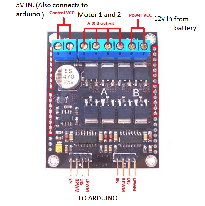

  1. What connections do you have between the motor controller, Arduino, and battery?
I have a 5v power supply going to the arduino and the "Control VCC" to control the chip on the motor controller according to the the instructions
tawandapro:
..and what ground and signal wire connections between the Arduino and the controller board?
The signal wires from the arduino to the motor controller are as described in the table on their website
The ground from the 5v supply is shared with the arduino

Hi, it looks like we will need to see a circuit diagram of your setup, either cad diagram, or a hand drawn photographed schematic will be fine.
Please include how your supply is connected.
As a safety feature have you got a fuse in the main motor supply lead to the controller, 50A is a lot of current to work with.
Also have you a multimeter to check that the motor controller is getting the correct signals.
This will help us a great deal to suggest solutions to your problem.
Thanks Tom..... :slight_smile:

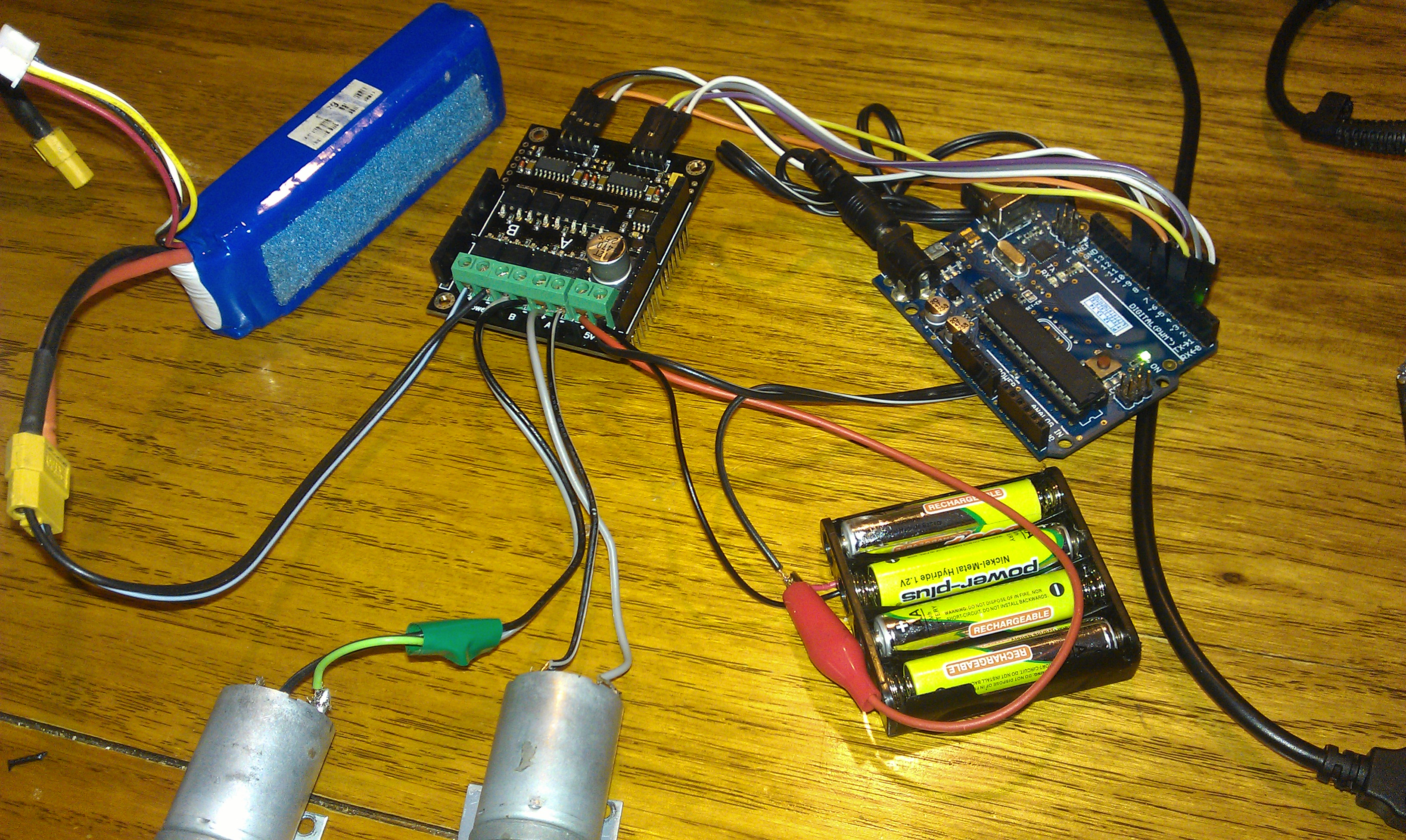

here is some pictures explaining
You appear to be feeding about 4.8V from the four NiMH cells into the Arduinio barrel jack. That will only provide the Arduino with a little over 3V, which may not be enough. I suggest instead that you connect the motor driver +5V and ground to Arduino +5V and ground, and power the Arduino either from USB or from 7V or more fed into the barrel jack.
I have tried using a 5v 1.5 Amp voltage regulator to both the arduino and the motor controller. I will try again with a separate 6v supply for the arduino and connect the 5v regulator just to the motor controller and hook it up the grounds from the arduino, the regulator and the 12v power supply. The seller told me to share a 5v supply from the arduino to the motor controller.
