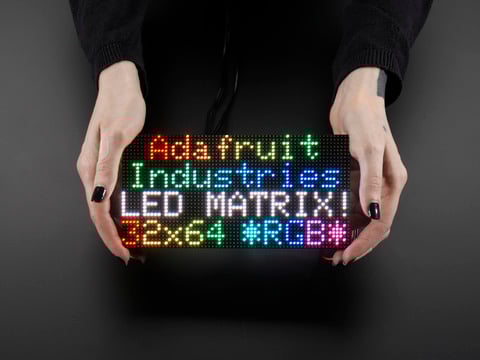

64x32 LED matrix
no... sorry I said this before and I didn't know I had a p5 but thank you.

that is the code. well the original code. cause i had to change some things cause I have a 64x32 not a 16x32
heres the gray cable:
really of stupid of me to put it on my bed. but my computer is by my bed so its easiest.
Is this what you bought?
If so please note that it says:-
There's a lot of LEDs! You may need up to 4A per panel.
How are you powering this?
no I bought it at a local store called vetco. And my power is 5v and 10 amps. too many amps? not sure... but whenever I'm programming it i just use my computers usb to power it and it can turn on all the Leds fine but its just glitchy.
thank you!
It is not fine. You need to supply the right voltage and enough amps. 64x32x20mA = 40A. Is the power consumption written on the back panel?
You can't have too many amps in a power supply. The current rating of a power supply is only the maximum current it will supply. It is not what it will supply. That depends on what load you connect it to. The only down side for having way too much current available is it becomes very unforgiving in the case of a short circuit and could vaporise connections.
By the way you need to connect the ground of this power supply to the ground of the Arduino as well.
These sort of panels don't use LEDs with a 20mA current consumption. They are also multiplexed and that reduces avrage current consumption anyway.

You need to select an example for 64x32 panel, because your matrix can't work with the code for 32x16 one. In particular, you need to connect "D" pin on the matrix to address a 64x32 panel
Even more - you forgot to multiply by three, because each pixel consists of three diodes - R, G & B.
But the good news is that this panel, judging by the inscriptions on PCB, uses multiplexing by16, so the real consuming is 16 times smaller.
hello. so right now, I'm working on is connecting my gnd from my power supply to the Arduino... does anyone have an image or video how to do that? I don't wanna mess anything up so I wanna just make sure.
You don't need to connect it directly, since the flat cable between Arduino and the panel has a several GND wires in it.
What should I power the Arduino with?
An external power supply.
