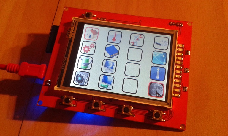

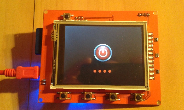

Now working with touch :slight_smile: when i have time ill fix up the touch part i like the way you done it
#include <SPIflash.h>
#include <UTFT.h>
#include <UTFT_SPIflash.h>
#include <UTouch.h>
UTFT myGLCD(CPLD,25,26,27,28);
UTouch  myTouch( 6, 5, 4, 3, 2);
int x, y;
char stCurrent[20]="";
int stCurrentLen=0;
char stLast[20]="";
SPIflash      myFlash(52);
UTFT_SPIflash myFiles(&myGLCD, &myFlash);
extern uint8_t SmallFont[];
extern uint8_t BigFont[];
extern uint8_t SevenSegNumFont[];
uint8_t  fileid;
uint16_t filetype;
int homepage = 0;
  myGLCD.InitLCD();
  myGLCD.clrScr();
  myTouch.InitTouch();
  myGLCD.setColor(255,255,255);
  myGLCD.setFont(SmallFont);
  myFlash.begin();
  if (myFlash.ID_device==0)
    myGLCD.print("Unknown flash device!", 0, 0);
    while (true) {};
setup0();
void setup0()
  myGLCD.setWritePage(0);
  myGLCD.fillScr(VGA_BLACK);
  myGLCD.setColor(VGA_WHITE);
  myGLCD.setFont(BigFont);
  myGLCD.print("7 TFT TOUCH SCREEN", CENTER, 0);
  myGLCD.print("CPLD PAGESWITCHING", CENTER, 16);
  myGLCD.print("SPI FLASH W25Q64FV 64Mbit", CENTER, 32);
  myGLCD.print("PROCESSOR: SAM3X8E ARM CORTEX-M3 CPU", CENTER, 48);
  myGLCD.print("INITIALIIZING PROGRAM", CENTER, 80);
  myGLCD.print("LOADING PLEASE WAIT", CENTER, 96);
  myGLCD.setDisplayPage(0);
  myGLCD.setWritePage(1);
  myFiles.loadBitmap(0, 0, 0);
  myGLCD.setWritePage(2);
  myFiles.loadBitmap(1, 0, 0);
  myGLCD.setWritePage(3);
  myFiles.loadBitmap(2, 0, 0);
  myGLCD.setWritePage(4);
  myFiles.loadBitmap(3, 0, 0);
  myGLCD.setWritePage(5);
  myFiles.loadBitmap(4, 0, 0);
  myGLCD.setWritePage(6);
  myFiles.loadBitmap(5, 0, 0);
  myGLCD.setWritePage(7);
  myFiles.loadBitmap(6, 0, 0);
  if (homepage == 0) {
    home();
    homepage = 1;
    delay(2000);
    image1();
    myFiles.loadBitmap(7, 0, 0);
if (myTouch.dataAvailable())
      myTouch.read();
      x=myTouch.getX();
      y=myTouch.getY();
      if ((y>=15) && (y<=74))  // HOME
        if ((x>=582) && (x<=641))
          image1();
      if ((y>=15) && (y<=74))  // SETUP
        if ((x>=654) && (x<=712))
          image2();
      if ((y>=15) && (y<=74))  // GRASS
        if ((x>=725) && (x<=784))
          image3();
      if ((y>=189) && (y<=248))  // 1
        if ((x>=14) && (x<=73))
          image4();
      if ((y>=262) && (y<=321))  // 2
          image5();
      if ((y>=334) && (y<=393))  // 3
          image6();
      if ((y>=406) && (y<=464))  // 4
          image7();
void home()
 myGLCD.setDisplayPage(1);
void image1()
 myGLCD.setDisplayPage(2);
void image2()
 myGLCD.setDisplayPage(3);
void image3()
 myGLCD.setDisplayPage(4);
void image4()
 myGLCD.setDisplayPage(5);
void image5()
 myGLCD.setDisplayPage(6);
void image6()
 myGLCD.setDisplayPage(7);
void image7()

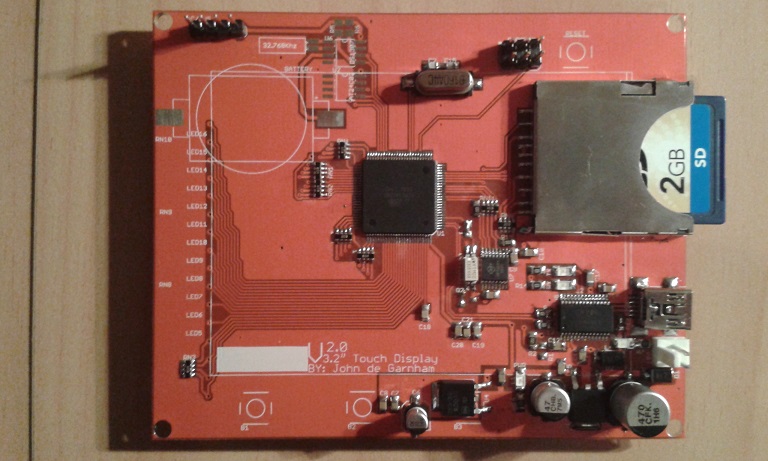

When i have time i will design a new control PCB for this 7" display just as i done with the 3.2"
