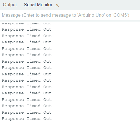

7 in one multiparameter soil sensor with esp32
Output
And I'm following the circuit diagram given in post #53.

Yes, i did this and got output as shown in my previous post #61
Ok. Let's work backwards and see what change we did that broke things.
Firstly, remove the lines of code I suggested in post #60 and try the sketch again. That code shouldn't have caused the timeout message but you never know.
If that still produces the "Response Timed Out" message, then change the pin numbers back to:
const int RO_PIN = 10;
const int DI_PIN = 11;
const int RE_PIN = 8;
const int DE_PIN = 9;
And move just those 4 wires between the UNO and the RS485 module back to where they were.
Im getting mixed output now!
Updated code:

In summary at this stage:
  • The wiring is as it was between the RS485 module and the UNO and the sketch definitions for the 4 pins you are using is back as it was.
  • You are powering the sensor from your 9V battery
  • You have the GND wire between your sensor GND/0V and the RS485 module GND and the UNO 0V pin.
I wish we could monitor what was coming back from the sensor. I don't suppose you have an RS485-USB dongle?
It's not helped when the Modbus library is reporting 2 different errors. I might understand if it consistently reported "Invalid Slave ID" as we could possibly put that down to the rogue 00 we were seeing.
I don't have it right now, but I can get it from Amazon. somehow I need to fetch my sensor values on the serial monitor.
until yesterday it was reporting an "invalid slave id", but all of a sudden it changed to different, I wonder why!
Can you try the sketch from post #41 again. Make sure that your RE, DE, DI & RO are defined correctly.
We may have to put the proper Modbus library to one side till we can get the comms stable.
Don't worry about getting an RS485-USB dongle. We can probably figure it out without one.
