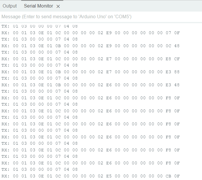

If your sensor responds, then the RX line should display some numbers in hexadecimal - hopefully starting with 01 03.
Hi marks, it gives me output like this.
No, my sensor works between 7 - 24 DC volts.
Since it mentioned between 7 - 24 DC volts, I'm using this 9V DC battery, is it not compatible sir?
Success! Your sensor is responding with what looks like the correct message.
You may be able to use that 9V battery but I don't know how long it will power your sensor for.
To get your code to work with the sensor, it looks like you need to correct the CRC16 checksum. That is the last 2 bytes in your command message byte array. The last 2 bytes should be 0x04 and 0x08.

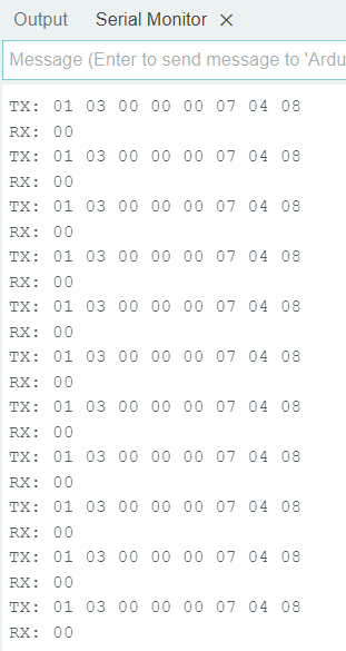

Hi, I'm getting output like this!
Strange. However, I just noticed that back in your post #42, the RX data starts with 00. That 00 shouldn't be there. The data should start with 01 (which is the slave ID). If your sensor is responding as it was for post #42, then the Modbus library will give you that error as it believes that the ID of the slave device responding is 00, when it is expecting 01.
Can you check your wiring - especially for a loose connection to the RE & DE pins.

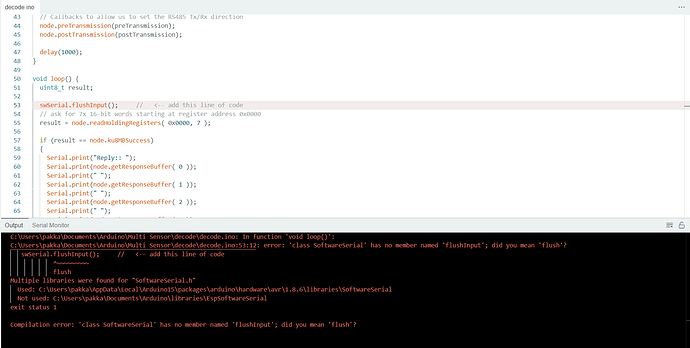

Another thing you can try is to insert the following lines at the start of the loop:
  uint8_t result;
  // remove any characters from the receive buffer
  while ( swSerial.available() > 0 ) {
    swSerial.read();
  // ask for 7x 16-bit words starting at register address 0x0000
  result = node.readHoldingRegisters( 0x0000, 7 );
Updated code

Output (Same as before but when i remove the sensor positive terminal ( red color wire), it says response time out!
i have checked, i dont see any loose connections
One more thing is that it gives output only when I connect the positive terminal(Red wire) of my sensor to the 5v of Arduino Uno and the GND of the sensor (Black wire) to the GND of the Arduino UNO along with/ without battery if I remove these pins it gives maximum hexadecimal value FF FF FF FF FF so on. is it causes any concerns?
Your sensor probably won't function correctly when powered from the 5V output of the UNO as the label on the side of your sensor says it's a 7-24V supply.
You could try the 9V battery to power the sensor.
Also, check that you have wires that connect the UNO 0V to the RS485 GND and to the 9V battery -ve - i.e. a common ground.
Yes, I meant this, I have connected a 9v battery along with giving a positive terminal of the sensor(red wire) to 5v of UNO. the output comes 00 01 03 and so on only if I connect the red wire of the soil sensor to the 5v of uno with battery or without battery, if I remove the positive terminal(red wire) of my sensor to the 5V of UNO, The output gives a maximum hexadecimal value which is FF FF FF so on.
hey, it was giving output as 00, 01, 03, 0E so on, but now all of sudden output changed like this!

You can change the RE & DE pins to suit your own setup, BUT the RO & DI signals must go to pins 8 & 9. That's a requirement of the AltSoftSerial library and the way it uses the hardware.
When you run the sketch, you should see it print out the TX message and then the RX message. If the RX message is the same as the TX message, then you have some confidence that your UNO and RS485 modules are working.
Yes, it's coming back what we are sent! still, I wonder why all of a sudden it started showing 00 in post #52. Since I connect 5V uno to my sensor, now my sensor at fault? because the NPK sensor ranges from 7-24V DC.
If you mean that you power your sensor from the UNO +5V, then that is likely to be an issue as your sensor requires at least 7V to function correctly.
The screenshot you have uploaded shows that stray 00 at the end of the received message. I'm not sure where that is coming from. The good thing, I suppose is that it is at the end of the message.
I suspect that the earlier code that reported back INVALID SLAVE ID was because the stray 00 was still in the receive buffer when the next transmission happened. The Modbus code likely then read in that stray 00 as the first byte of the response and would have generated that error message as it was expecting 01 as the slave ID.
I just had a look and there is a command that you can try - it should perform the same function as the bit of code I gave you back in post #48. Change your code by adding in this line:
  uint8_t result;
  swSerial.flushInput();     //   <-- add this line of code
  if (result == node.ku8MBSuccess)
I found one error
should I replace swSerial.flushInput() with swSerial.flush() ?
Oops. My fault! That function only exists in the AltSoftSerial library.
I'm wondering if the rogue 00 is generated when the RS485 module goes into TX mode. If you re-insert that bit of code I gave you so your loop starts with this:
  uint8_t result;
    swSerial.read();
Let me know what happens.
