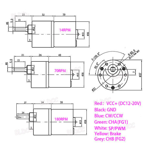

I recently was given a 12v, 7-pin brushless motor without much data. I believe it is a "dual channel phase-tracking encoder" - but I'm struggling a bit to understand what that all means. I tend to understand things better once I have some code and schematics in front of me!
I was hoping to get some advice for how to safely attempt to drive it with an Arduino, not knowing entirely what I'm dealing with.

Searching around I found a similar motor with this color code:
Red +12
Black ground
Green frame ground
Yellow fwd/rev
Blue pwm speed
White brake
Does that help ?

Great - this seems to get me into the ballpark. Powering the device with 12v to Red and GRD to black makes sense to me. I will try that and see if anything runs.
I'm a little less certain about the anticipated signal for the other wires, though. I'm assuming some kind of voltage applied to Blue can reverse the direction - and that White is expecting some kind of PWM signal to modify speed* - but I'm not sure what "SP" means.
FG1 and FG2 are also a little obscure to me - but as page suggests there is a "two channel pulse signal output" - I suspect that might be the White and Grey wires.

That ebay link has some model numbers, like "3630-37-14", and plugging them back into google gives this ebay link: Brushless DC Gear Motor DC 12V BLDC Gear Motor PWM CW/CCW Dual Channel Pulse | eBay which has this wire ID diagram:
That might be a place to start.
The pwm signal will be a square wave at around 10khz where the duty cycle represents the desired speed.
FG means frame ground and can be ignored. A logic level high signal means forward and a logic low is reverse.
The CHA and CHB part of the CHA(FG1) and CHB(FG2) might mean encoder A/B channels.
Or possibly the pins might be alternate FG1/FG2 Frequency Generator signals as per https://www.hitachi-power-semiconductor-device.co.jp/en/products/ic/pdf/PDE-ECN30216S-2.pdf if the motor happens to be equipped with that feature.

I plugged in the 12v this evening (12v to red wire, grd to black wire). No movement just yet.
Then I plugged in 2.5v, using a 5v power supply over a voltage divider, to the white wire. This started the motor moving.
The question I would have is what the best way of giving the motor a voltage would be. Could I simply take the 12v power, put that through another voltage divider, and send it to the white wire? Does the white wire need a separate voltage source? Should I be using a voltage regulator?
The speed control is PWM. Connect it to a PWM pin on the Arduino and set PWM values according to desired speed (using analogWrite(x)).
