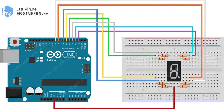

I'm a teacher and I have 70 Elegoo UNO R3 arduino kits from amazon. The 7 segment displays kept burning out on me last year, so I instructed my students to use 330 ohm resistors instead of the 220 ohm resistors suggested in the elegoo instructions, and I ordered a new class set of 7 segment displays from amazon. Now these new ones are burning out at an even more startling rate. Frustratingly, it is even seeming like some LEDs have burned out between last school year when I tested them all and the start of this unit. I'll have students using a display in one class period, and then in the next class period it will be burned out for the next student, both with the same circuit. My students are not observing the lights being on for a second and then turning off when burned, except in the rarer cases where my students do mistakenly have the wrong circuit.
My students are using one 330 ohm resistor on each of the LED pins, for a total of 8. I am confirming that their wiring is correct. Some of my units that have burned out are labeled with HG5611AH, 5611AH, CL5611BH, 5161AS. I am aware that some are common cathode and some are common anode, but there doesn't seem to be any correlation between units burning out and their serial number.
I am at my wit's end with these things. Should I start using 1000 ohm resistors? Should I suspect that somehow the arduinos are sending spikes of voltage above 5V? I haven't found any suggestions online except to be conservative with resistors.
Please post the schematic of one of your project that has damaged your displays. The schematic should show all components, how they are powered and connected to the Uno.
Please also post a sample sketch that uses the hardware, using code tags when you do
This schematic is electrically identical to what all of my students have been using, except that the resistors that we have been using all year are 330 ohms, and when students use common cathode displays the wire connected to 5V would be connected to ground.
Here is a sample snippet of some code that my students would be using to turn a Serial input into a number on the display.

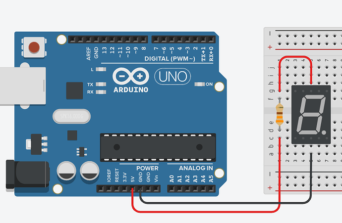

I've just had a thought. I'm aware that supplying 5V of power to the display without a resistor will be too much for the LEDs and can burn them out. I have been warning my students to avoid this, and checking their circuit for this possibility each time they inform me that a display is not working so that I can be aware of the mode of failure if it happens. However another mistake that they often make while testing their displays is connecting power to pin 3 and ground to pin 8 [as shown below], almost always with a 330 ohm resistor on the 5V line as they were instructed to have. Could this do damage as well? My own intuition tells me no, that the current should just pass through the display and that there would be no voltage drop over the LEDs, but I am struggling to think of a scenario that could cause this widespread failure.

5611AH's use 10mA under test conditions, so with a Vf of 1.8V, that works out to 320R series resistance needed @ 5V. So 330R should be perfectly safe.
IF the displays are meeting the datasheet specs.

To test - replace the 330 ohm resistors with 1k resistors. View the display in dim light. If the displays survive, yeah, it's a device that isn't up to snuff, but there's nothing else wrong. Seriously, I doubt a broad range of devices fail similarly.
One thought. Check your 220 and 330 ohm resistors. Make sure that's what they are. Not an insult - I've seen "brown" lines that were nearly indistinguishable from black lines on other resistors. It's an incredibly remote possibility you've got mismarked components.

The absolute maximum reverse voltage is 5v according to the data sheet but with a Uno you will not exceed this even assuming an accidental polarity reversal. However, it does seem close to the maximum.
A silicon diode (say 1n4007) in series with the common could lower the risk.
