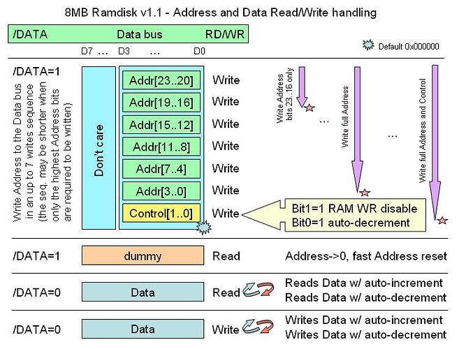

When you need to set the Address to 0 (for example when always writing/reading a buffer from ramdisk's zero Address) you may use this shortcut:
// reset the Address to 0x000000L
inline void resetadr (){
NDATA = 1; // address mode
NRD = 0; NRD = 1;
NDATA = 0; // data mode
Moreover, you can stop writing the Address nibbles after any nibble written :P, thus you may write in only "required" number of Address nibbles (1 or 2 or 3 or 4 or 5 or 6).
That allows to speed up with setting the Address, for example you work with 128 blocks 65kB each, so you must not set all 6 nibbles of the 8MB Address, but only top 2:

With a standard external HW SRAM buses on DUE or PIC32 or others, you may simply write the 24bit Address with A0=1 (when for example you use A0 address line) and then you read/write all the Data bytes from A0=0. You must not mess with bit-banging the /RD and /WR signals, or with the setting of a 8bit Data port direction - that is done by the MCU's external memory bus for you (EMB on DUE, PMP on PIC32, FSMC on STM32, etc.). You have to set the timing of the /RD and /WR signals as required, however.

You may connect the 8MB Ramdisk to your DUE via DUE's External Memory Bus easily:
With Ax = 1 you write in the 24bit starting "Address"
With Ax = 0 you write/read the Data bytes sequentially from the "Address"
You may use any DUE address line.
