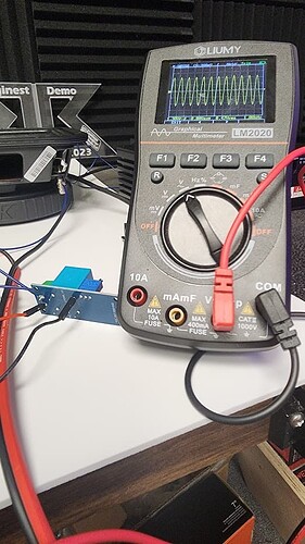

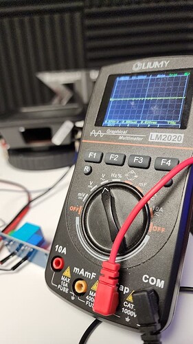

Image of signal.
Transformer output

Probing at these two points I get no reading.
The current into the primary is really tiny, using a 820k resistor... Is this the voltage measurement you are trying to make? The sensor is a current sensor, the primary has few turns and the secondary has many.
Correct, as this sensor module is designed for measuring mains voltages.
In theory, I should see some output from the transformer?
