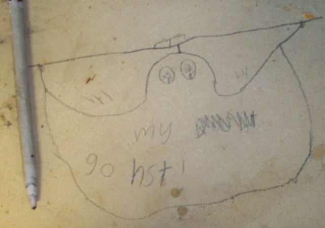

a Ghost

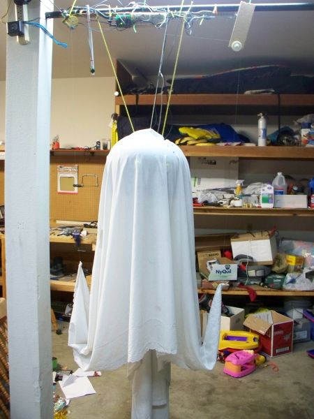

Here is the ghost

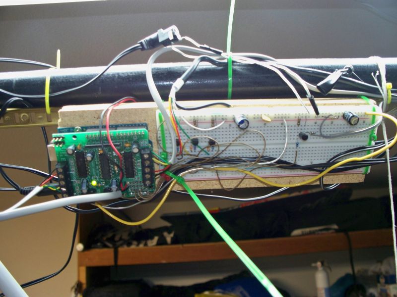

It has the latest arduino and Ladyada motorshield
Ther are three pair of LED - green and two red.
Red ones are closer to each other and lower - when you walk close, his eyes follow you.
There are two stepper motors supposed to lift his arms, but they do not work very good. The morots are from CD drive, and are not powerful enough (they try hard though), or may be motor sheild does not yield enough power?
There is vibrating motor from toy frontloader. With 12V it vibrates way to fast - you cannot really see it on a video, you can just hear the noise, but when you come close, and it suddenly start vibrating - that's spooky :slight_smile:
The ghost, just like a bat, uses ultrasonic distance sensor :slight_smile:
Here are some pictures:

No, you do not have to touch it - it uses EZ1 ultrasonic sensor.
I need to update hardware, so it will work form longer distance.
This project is failure. It "follows" your approach with "eyes" and shakes pretty cool. However, stepper motors from CD do not have enough torque to lift ghosts arms. I tried to power them with 12, they get overheated. Besides, when they work, +5 drops on motor shield to +4.5, which affects distance reading from EZ1. (I use 2 power supplies - +9 Arduino and +12 for motor shield)

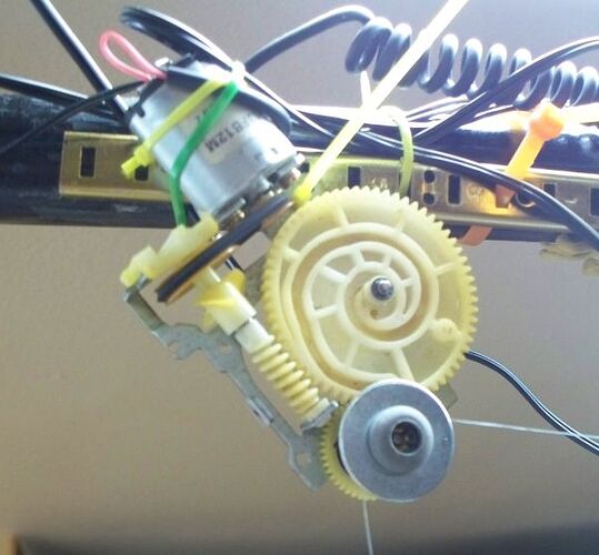

I consider replacing stepper motors with DC. Let's say, turn them on for a few sec, then let arms go down by gravity - make sure motors are idle for 3 or 5 sec. I have DC motors, but not decided how to attach a string to them yet.
Oops, I mean, I need to update software. This is tricky - the ghost is permanetly mounted in a garage, so I need to bring my wife's laptop there and use chair to reach the board :slight_smile:

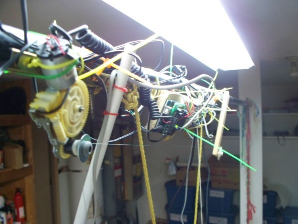

I have updated the ghost!
If you look closer, you will see - it moves arms up and down - you can see an arm at the right of the ghost.
Sad thing is - my kids no longer afraid of it (I'm holding some of them on the video) :cry:
Ok, some technical details:
  • I have removed stepper motors
  • I have added 1 DC motor
  • I linked both arms with one string, so when one arm goes up, the other one goes down.
  • I move them for 3 secons then stop. Move is triggered when you come to some distance.
