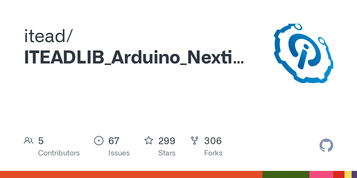

Is this the library you're talking about?
My advice is to fork their library on GitHub and then publish your changes to the fork. Submit a PR for your changes back to their repository. It seems like Itead is not actively maintaining that library any more so there is a good chance your PR won't get merged, but it will make it so that people can easily find and use your fork.
There are some issues with the structure of the Nextion library that have been causing problems recently. I was thinking of submitting a PR to fix them, but there has already been a dedicated issue report about the most important one for the last year with no response, and another issue report that mentions it that's 2 years old with no response, and I don't have interest in maintaining my own fork of the library for such a trivial change so I haven't bothered. If you made a fork for your improved version of the library, I'd be happy to submit my PRs to your fork instead.
