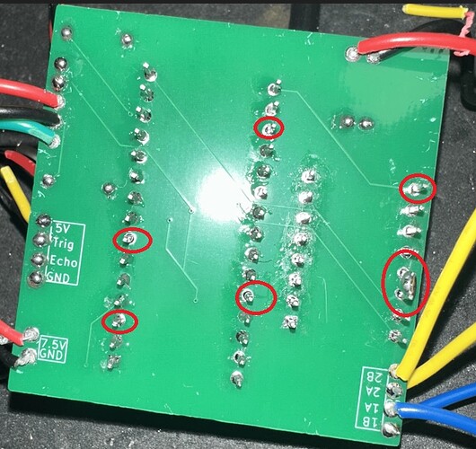

Can you please post an image of the other side of your PCB?
You haven't answered if you have resoldered the joints I pointed out.

What do you mean by soldering in straight? Here is the other side of the PCB
I see many bad solder joints there.
Watch a video, practise some soldering and redo all of them.
The biggest mistake beginners make is to put solder on the tip of the iron before soldering.
That burns off the flux inside the solder that you need for a shiny joint.
put the solder on the preheated pin/pad, not the tip of the iron.
Leo..

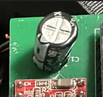

Hi, @kaipo1
Look at the electrolytic capacitor and where its negative marking is, it is not at the right angle when you look at the PCB pads.
These are just some that appear to be possible open circuits.
Not sure about the solder join between pins, is it supposed to be like that?
You need thicker tracks and thicker solder pads, to give you something to solder too.
