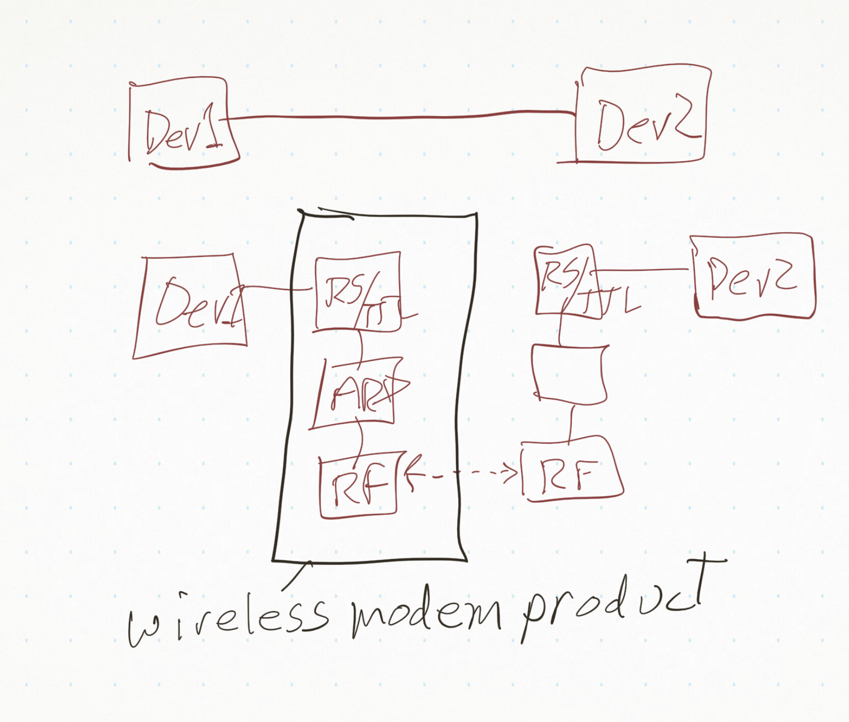

As far as I understand the Garmin Striker Vivid 5cv model is NMEA0183. The sonar mirror comes with a 4-pin cable. The monitor also has 4 pins for mirror connection and has a different input for power supply. How can I communicate these two remotely? I thought with Arduino, RS232 TTL converter and Lora. But if there's an easier way, I'd be very grateful..
This is what I am talking about, 1000 words. I repeat, I have not done this; I only hope if I ever need to do it will be as simple,e as plunking down the money for the wireless modem set.
I will learn here if my hope is correct.
You can have fun making your own wireless modem out of parts laying around the home (mine anyways) or you can buy some wireless modems.
Sorry if it looks like I drew the diagram using my finger sitting under the umbrella at the beach. There's a reason that's what it looks like.
But the thing in the big bold box is a 1. converter to get the data in and out of an 2. Srduino which then uses some kind of 3. RF module and code to transmit/receive the data with another identical setup.
It's down to what kind of fun you want to have and I suppose where you like to spend time and/or money.
a7
As far as I know, LoRa is a packetised comms system and would need quite a lot of protocol to transmit serial data transparently. As I understand it you are seeking a "wireless wire" that just replaces the data cable. That appears to be what the Zulu product offers.

What distance do you need to communicate over? There's a class of devices called "wireless serial modems" or "wireless serial servers" whose job is to take an RS232 signal and transmit it over a radio link to another device. The specific device would depend on what features you need. Here's an example: https://www.digikey.com/en/products/detail/aim-dynamics/USR-W610/13530863
Depending on how far you need to transmit, it may be simple to DIY, or not.

400m over water isn't bad. This could probably work: SparkFun LoRaSerial Kit - 915MHz (Enclosed) - WRL-20029 - SparkFun Electronics
and it's available off the shelf at a fairly low price.
Thank you very much, I will look into it. It appears as LoraSerial, I hope I can find products close to it, because it is very difficult to procure this product..
