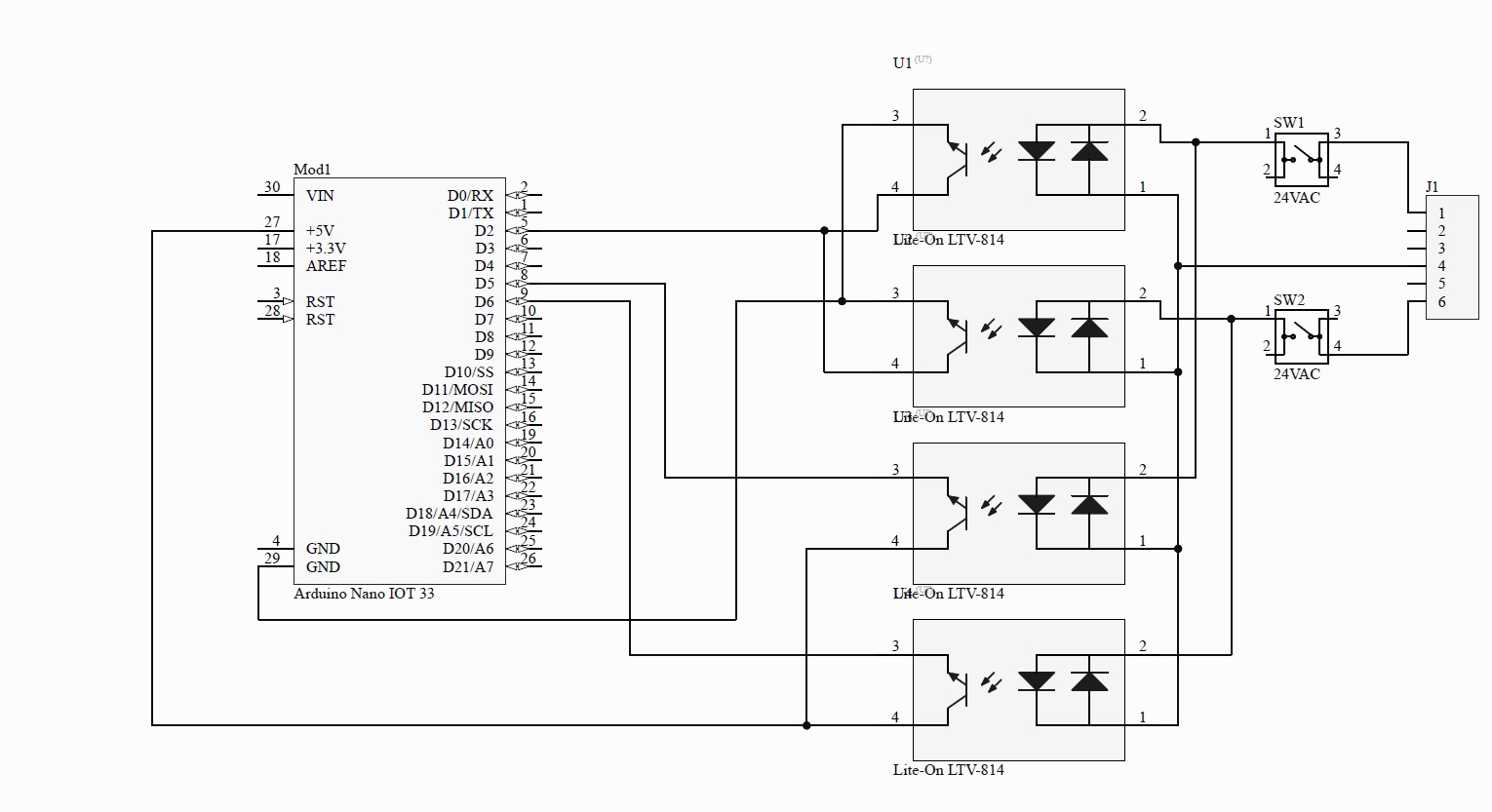

I am replacing an EX100 PLC system with an Arduino Mega. The control voltage is 24VAC in the machine. There are 8 push buttons so can't use interrupts for each one.
I have used an ISR multiple times with a Common Interrupt Pin and array of pins for each push button. I want to use the following Push Button interrupt code:
attachInterrupt (digitalPinToInterrupt(common_Pin), isr_ReadPB, LOW);

I was going to use 2 LTV814 optoisolator:
PB Circuit.pdf (110.7 KB)
Due to space, I need to reduce to a single chip for each push button. I looked for a optoisolator triac that has AC input. Can't find any!! I know a triac only shuts off when current is low. I tried the circuit with a DC input and every time the code changes from Common to Distinctive, it shuts the triac off and works fine.
I was hoping someone can direct me to one or an alternative.

I am not sure what you are doing with your schematic. You can use one optocoupler and integrate the signal. The optocoupler on the schematic will detect AC, both phases. Add a capacitor to the output of th coupler ie. the input to the Arduino. Not sure what the pull up is but if it is the Arduino it will change from pin to pin and processor to processor. This will give you an input if a button is pushed. You can pole or use the pin change interrupt.
Thank you very much. I read over the SSR information and realized it was a simple solution. I put a 1N4007 diode in parallel to the MOC3023 LED, after the resistor.
The MOC3023 triac works great. Just like a PC814 optoisolator with a triac output.

ILD620-ILQ620AC optocoupler.

Why do you need a triac to connect the GPIO pins? Triac is to drive a AC load. Where is you're ac load in the schematic?

So, I need to read an input as an input first then as an output. Similar to a H-Bridge for a DC motor. This is why it needed to be triac.
