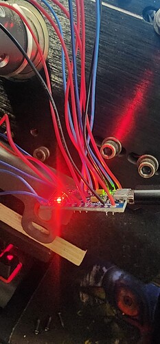

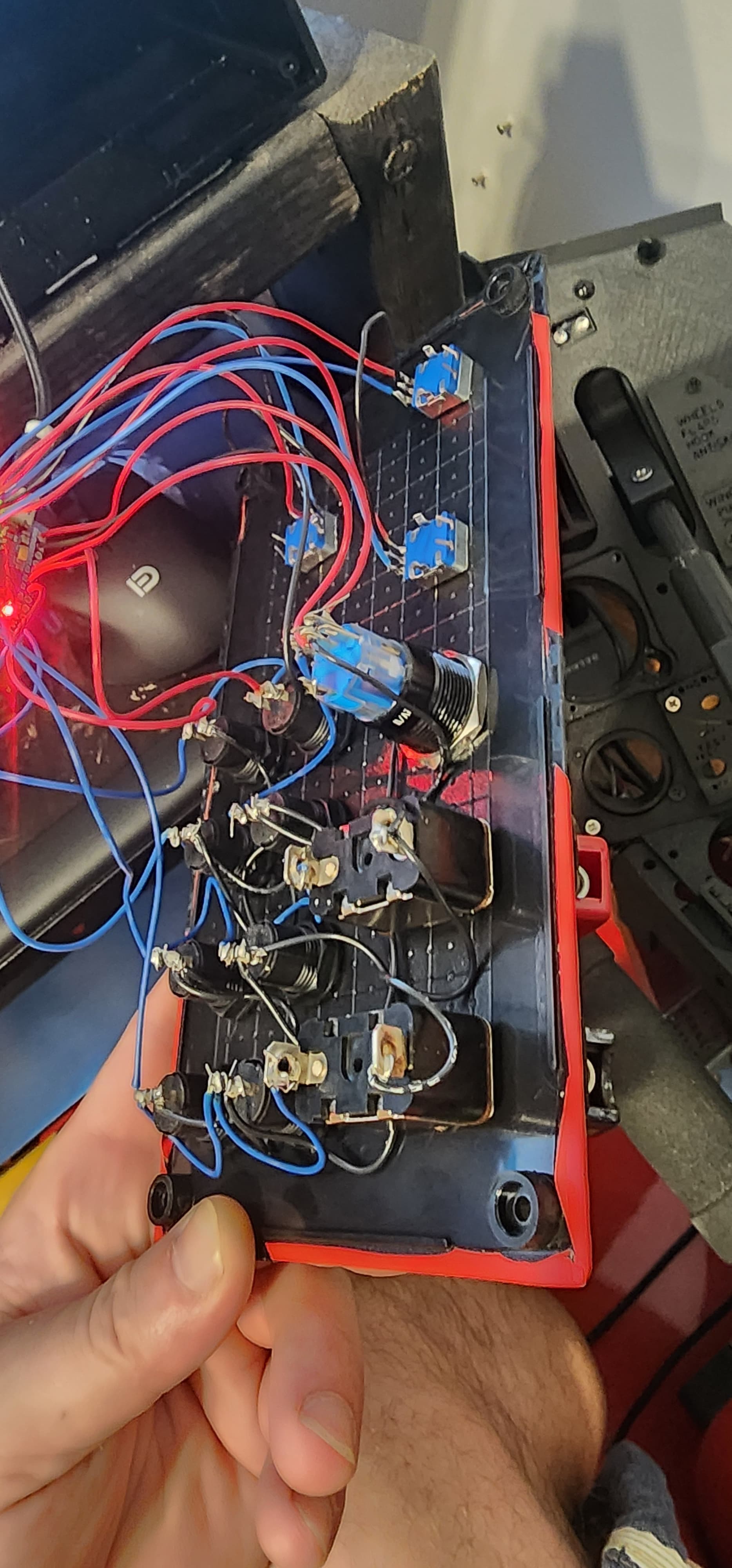

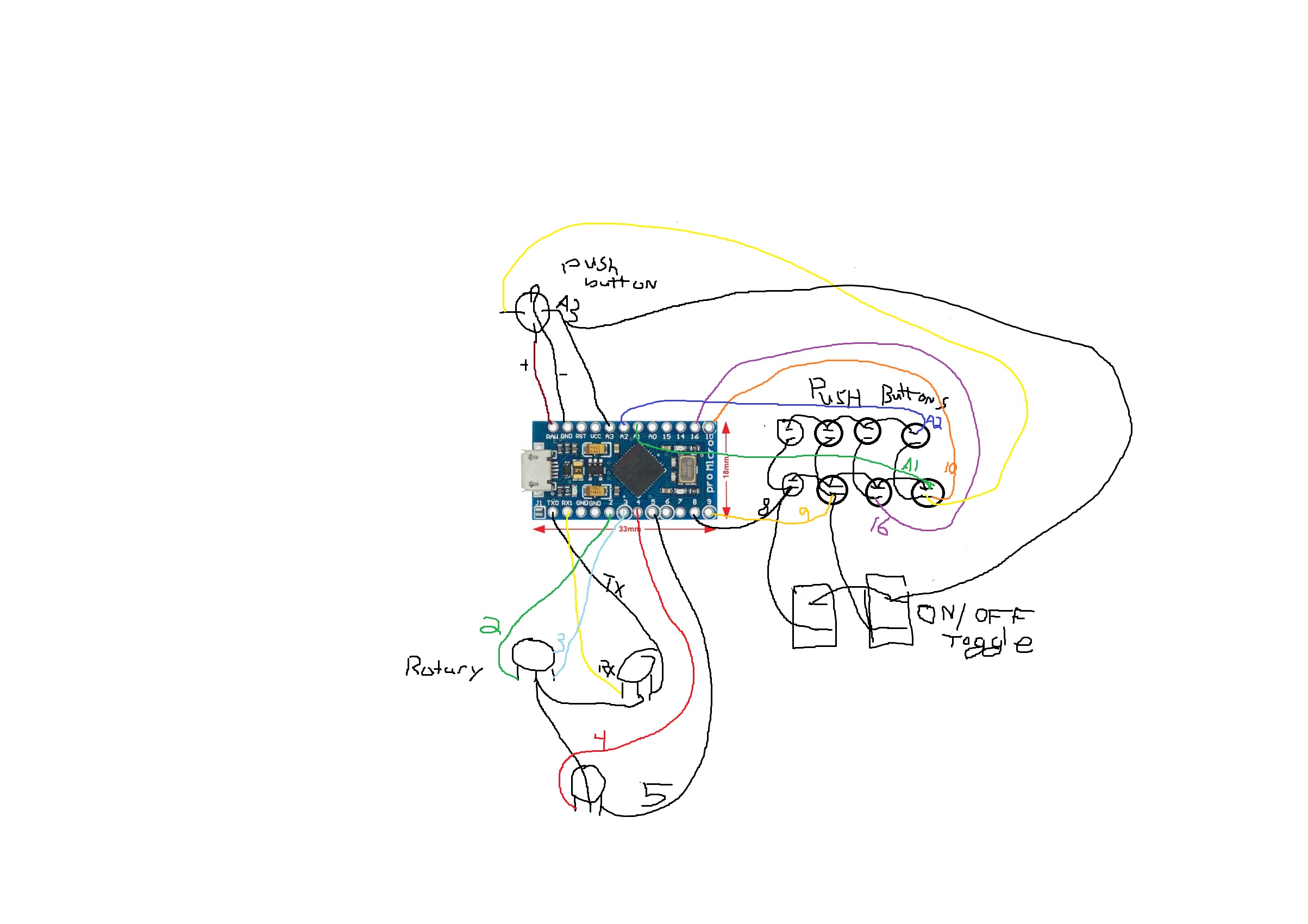

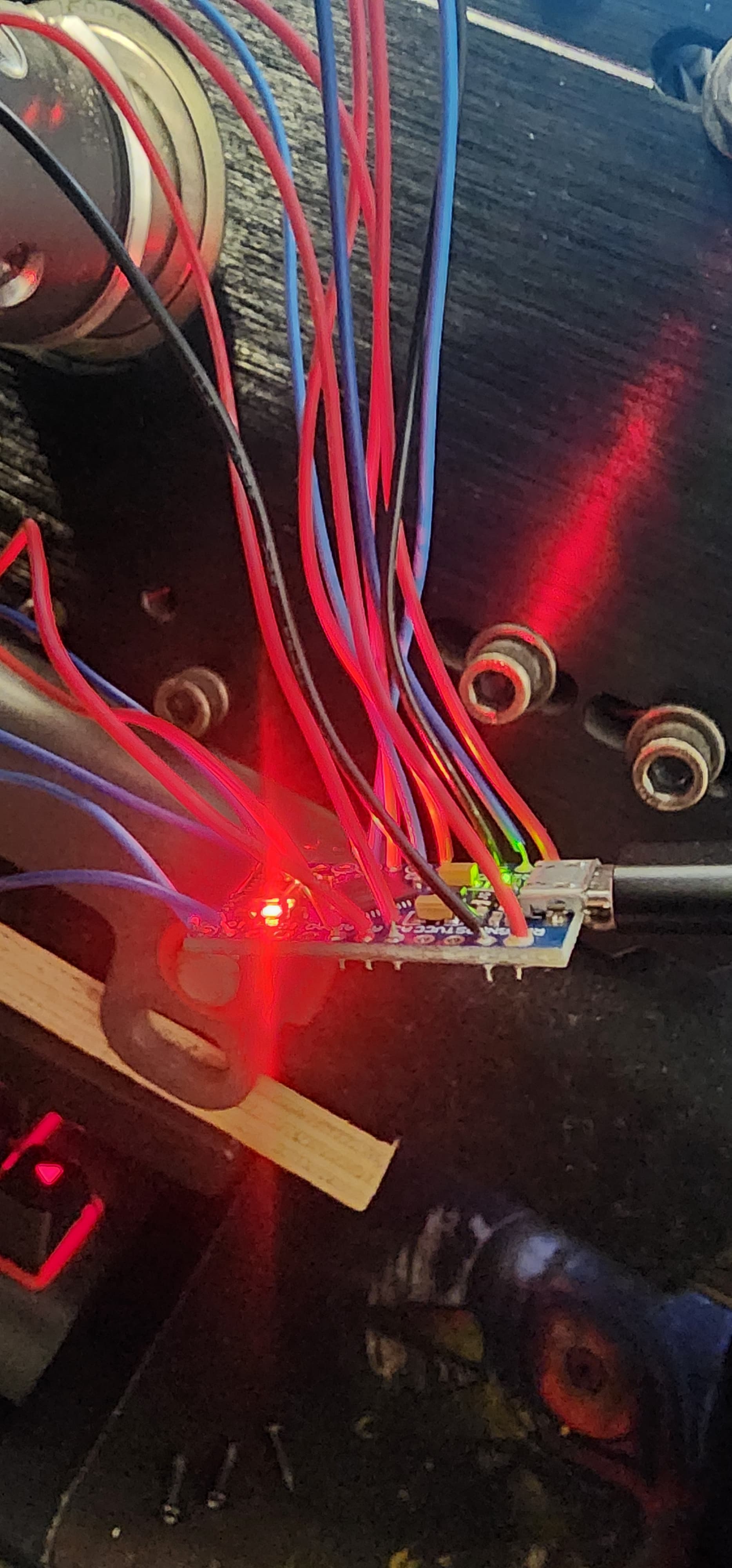

so i was coding for an iron man helmet wrote over the wrong code and now im stuck. lol ive opened her up and its a matrix style wiring is there any way i can get someone to write me up a code i have no idea whatsoever with what im doing.
- Trace each wire.
- Label where it starts and where it ends.
- Label devices.
- Draw a wiring diagram.
- Write code (with help).

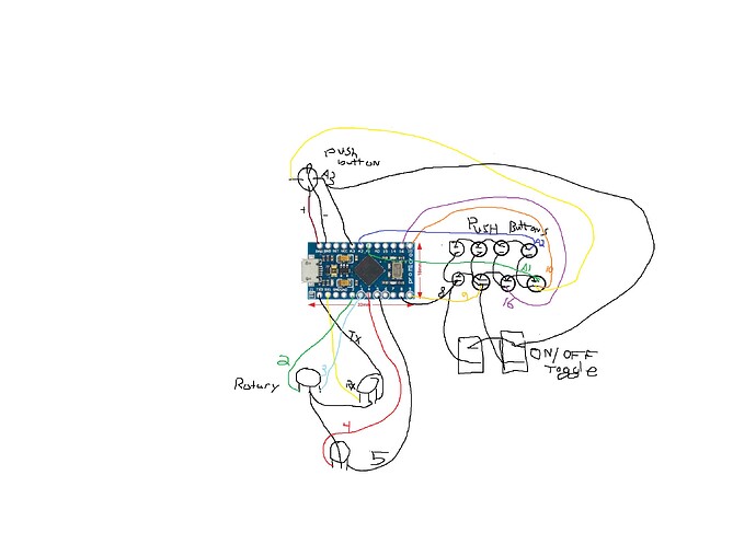

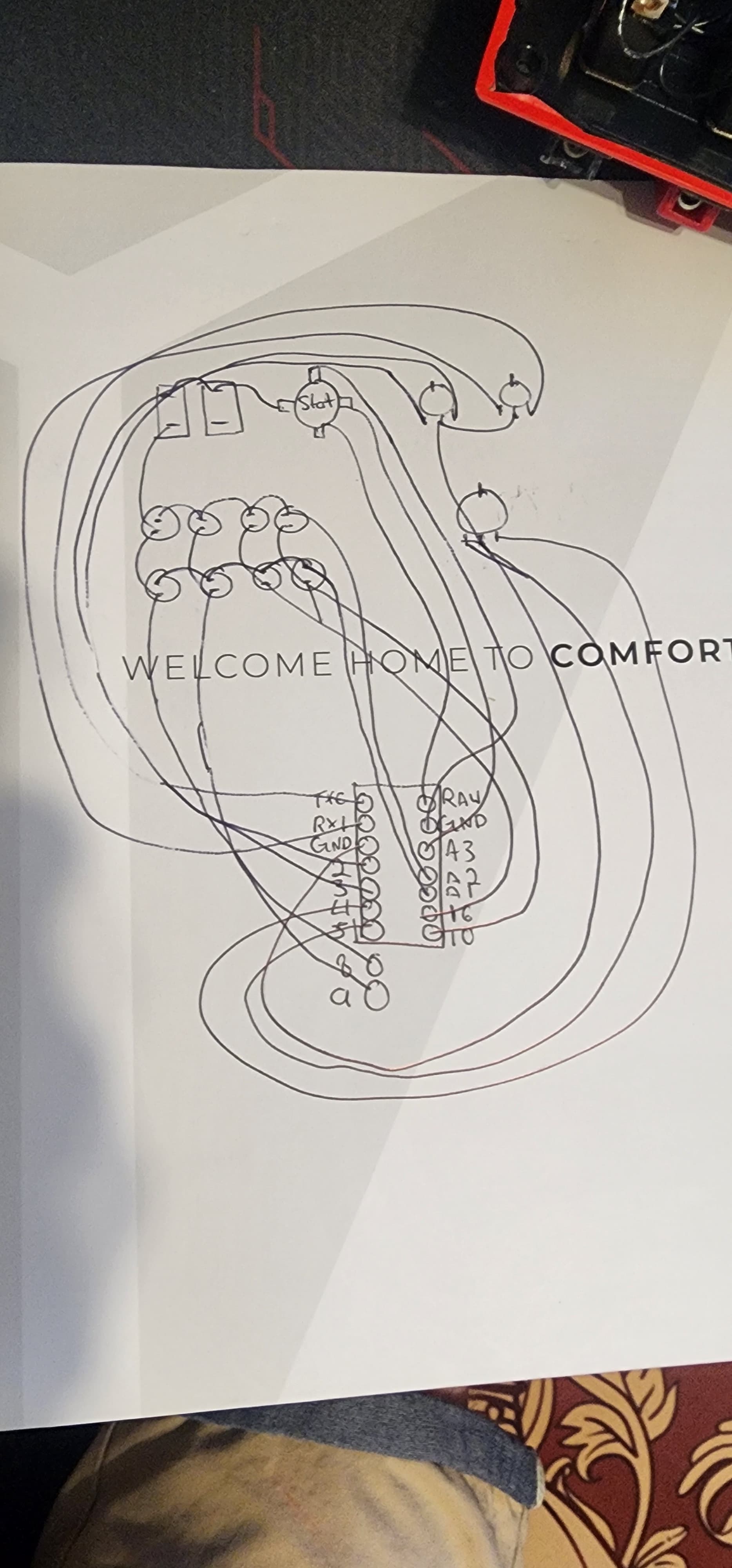

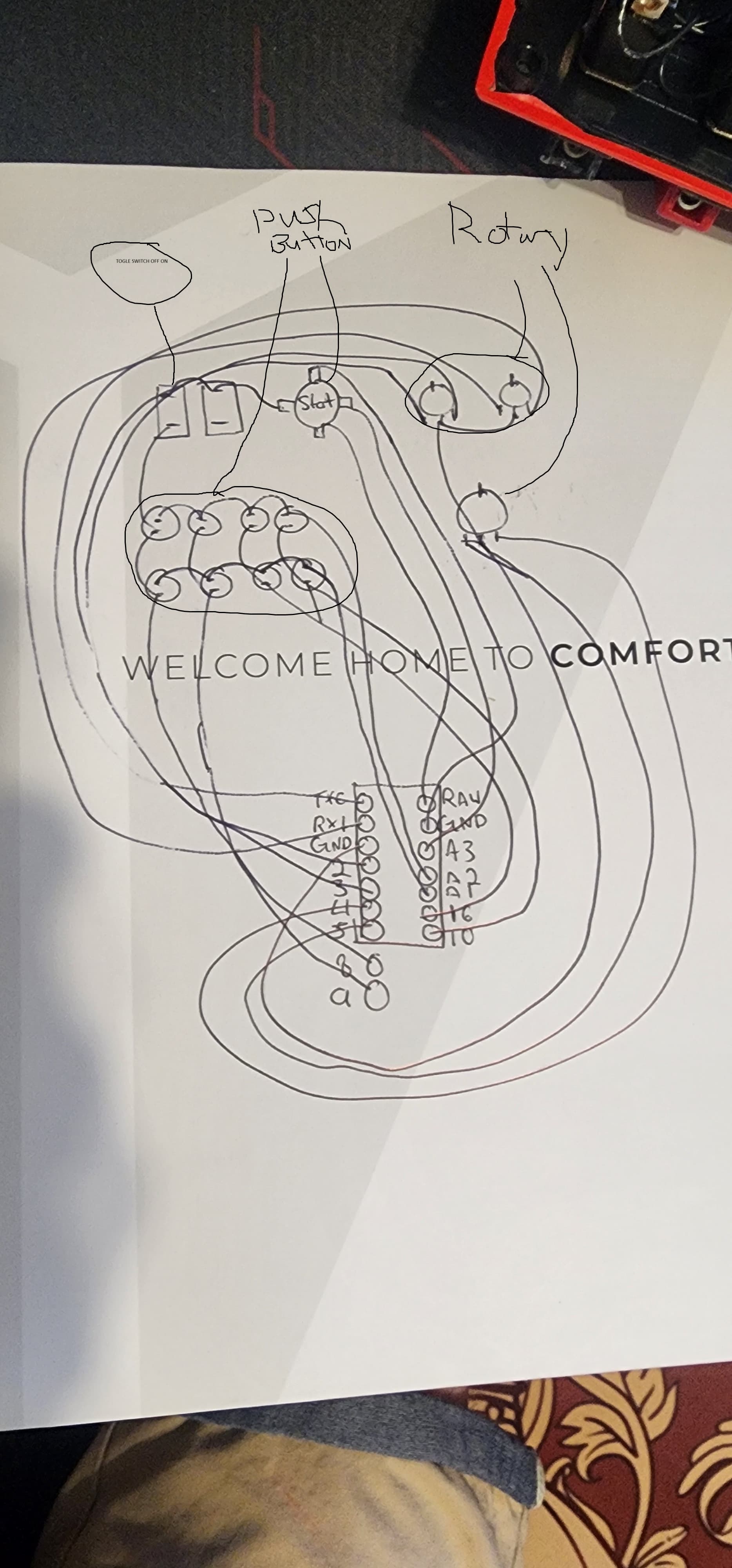

Good start. Make it legible.
haha your right i tried to read my own diagram couldn't do it.

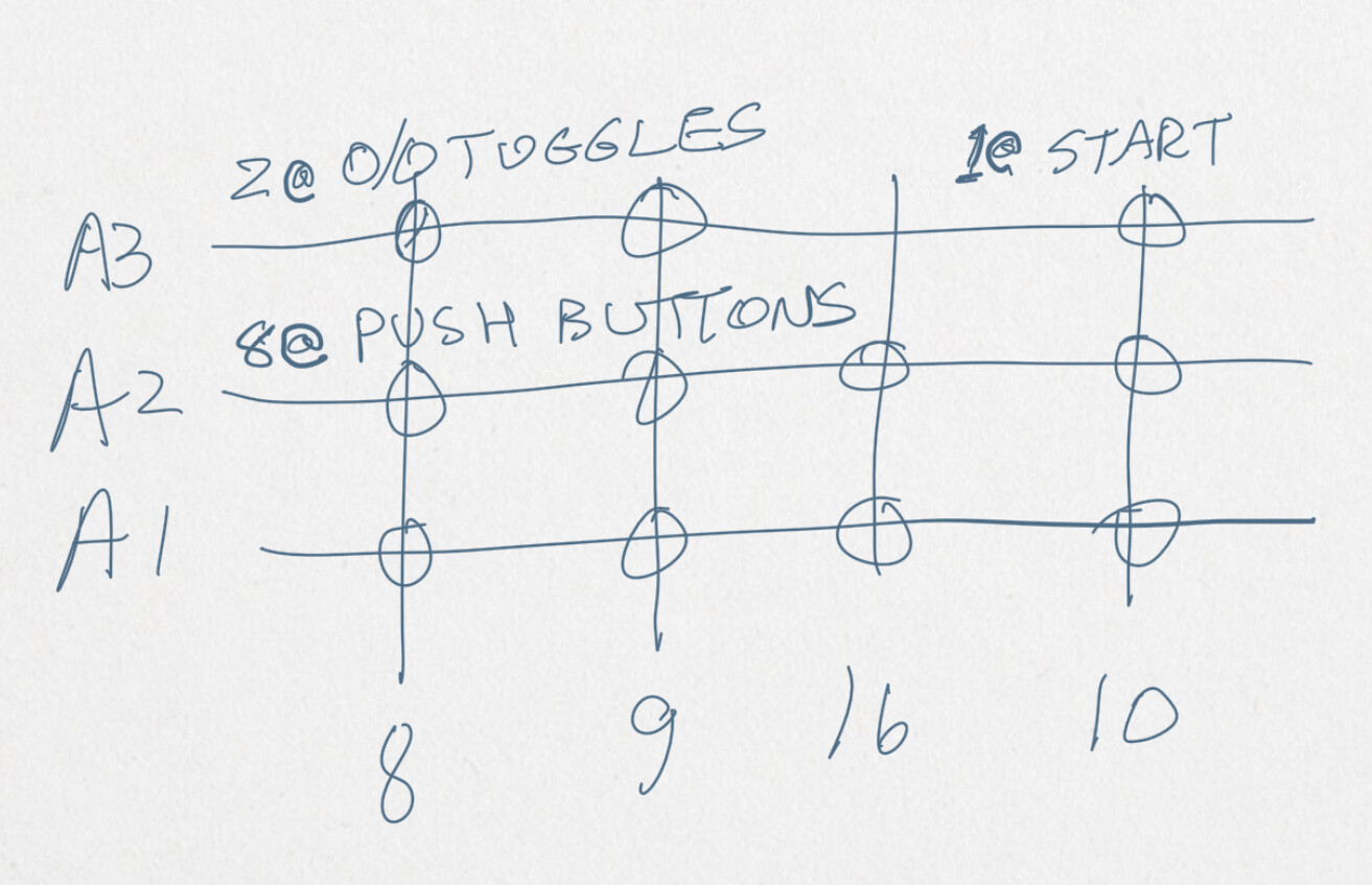

a3 is Normally open and Closed is attached to push button indicated as yellow on illuminated start engine push button.
Draw a circuit diagram.
Just one example here .....
The "pushbutton" with four wires... is connected to RAW... which is a Vin pin... how is power showing at the pin to pass power to RAW?
RAW is the unregulated voltage input for the Pro Micro. If the board is powered via USB, the voltage at this pin will be about 4.8V (USB's 5V minus a schottkey diode drop). On the other hand, if the board is powered externally, through this pin, the applied voltage can be up to 12V.
The nine pushbuttons and two toggle switches are in matrix configuration. With the toggle switches I would expect to see diodes, they would be useful even if there were only momentary pushbuttons.
But I make no sense of the "rotary" devices depicted - what is the involvement with TX0 and RX1 all about?
And code can be written only if… you say what it is supposed to do.
a7
Does it look something like this: Button Box Schematic found by a Google image search which turned up 100s of examples.
Search on: arduino button box
so i did search and try 3 or 4 different codes but i was getting an error withe the joystick and keypad libraries. when it comes to coding i am a potato, i usually buy leo bodnar boards as game device controllers. at the point i just dont know how to get the matrix code to work with my board.
so there rotary encoders the whole setup is used as a game device controller aka "button box". i hope this answers your question i got the item given to me or i would have followed another diagram with code already written. if you need anything else il keep an eye out to answer quickly i do appreciate the help!

im getting joystick id errors and im assuming its because all of my pin outputs are different?
Too much time playing video games and not enough time studying.
Anyway, post links to the project which seems closest to yours and links to its schematic and code if available. Someone may help you to incrementally restore functionality to your board.
Edit
It looks like our posts have crossed.
your not wrong but when it comes to things like coding, it makes me want to piss myself where i sit and rip my hair out at the same time. Im blue collar so i like to build and tinker solder and install. I just cant code for the life of me and or get into it.
