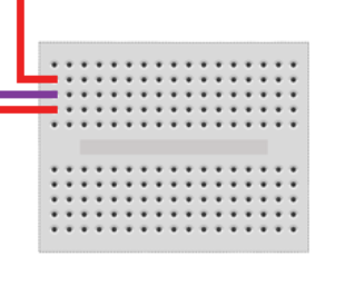

I am working on a project where I need to control the motor speed of a DC motor with an encoder. I am using this motor, an Arduino UNO, an L298N motor driver, and a 12V power supply. The circuit diagram is attached below.

What is this? Are you using the breadboard as a junction point?
Please take a pen and paper, and draw a complete, fully annotated schematic. Also provide links to all your actual hardware devices, or else post complete specifications.
Sorry, but your diagram is not useful. For example, there are rainbow wires from the motor, but no labels to tell what they are.

My apologies, this is my first time posting. I changed the diagram to hopefully give more information and linked the hardware I am using.
Thanks for the updates. However, in future don't edit previous posts, it makes replies into nonsense. just add information in new posts.
