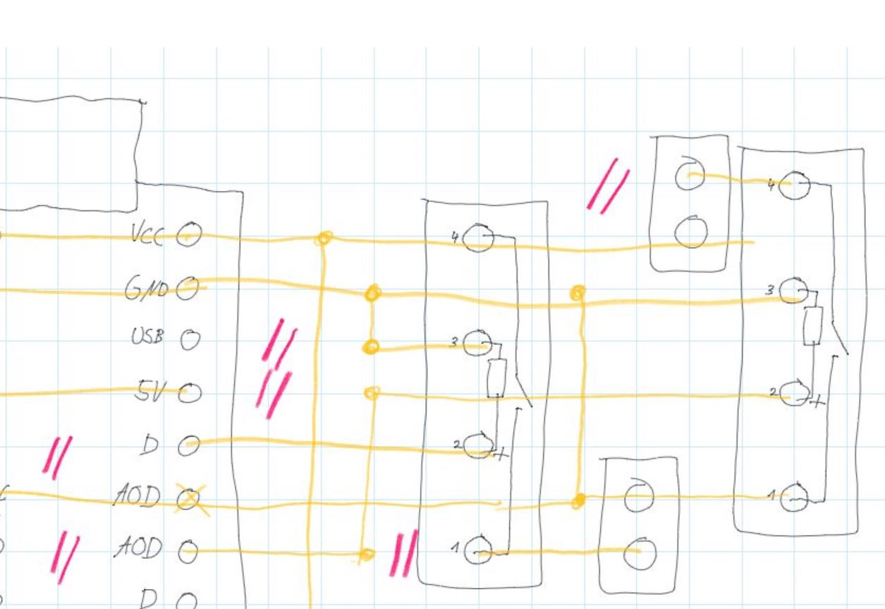

Hello,
With "powering the circuit" I of course meant activating the relais which in turn sends the current to the actual circuit components.
The Relais activation should not take that much power (i assumed).
I attached an image of the circuit (circles are actual solders to the circuit board). I did only do the displayed part of the circuit yet, the connections running out of the image shouldnt have any impact.

Still no image or schematic. Did you test all the grounds for continuity back to the power source?

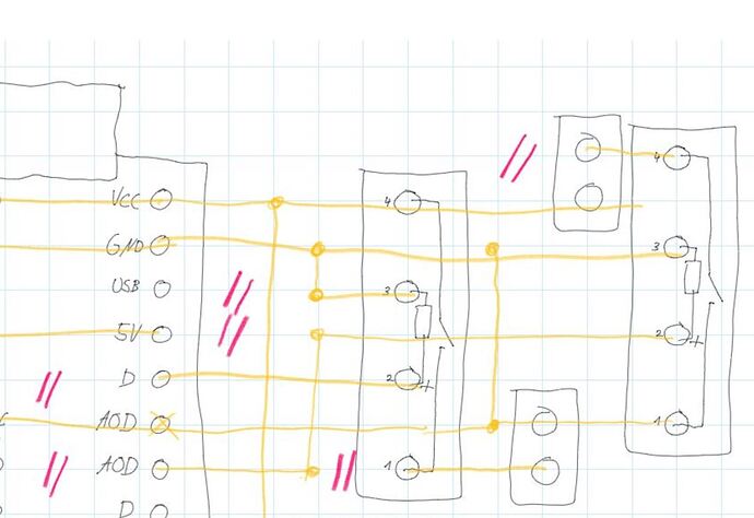

Sorry, pls see the circuit in the attachment.
In the meantime I recreated my circuit, so that it JUST contains the components displayed in the picture. Still not working.

Looks like you're trying to source coil current from D and A0D.
The Trinket can't output too much current on the IO pins. I'd suggest adding a current buffer.
I would connect one end of the coil to the + supply (5V, 12V, whatever they need) and use a simple NPN transistor to sink current thru the coil. IO pin to a 150 ohm resistor to the NPN base, NPN emitter to Gnd, and NPN collector to the coil.
Add a diode from the collecter side of the coil to the supply; anode on the collector side, cathode to the supply side.

That relay (assuming you are using the 5V coil variant) has a coil resistance of 500R, which would mean a current of only 10mA and no need for a transistor. It may also have a protection diode built in. What is the exact model number printed on the relay?
Using a transistor instead of the relay depends on what you are switching with the relay. You mentioned "valves" earlier but gave no detail. I would think a logic-level n-channel mosfet could replace the relay, such as stp16nf06l or similar. But need more details to be sure.
Right now, I can't understand why your circuit is not working with the relay.
