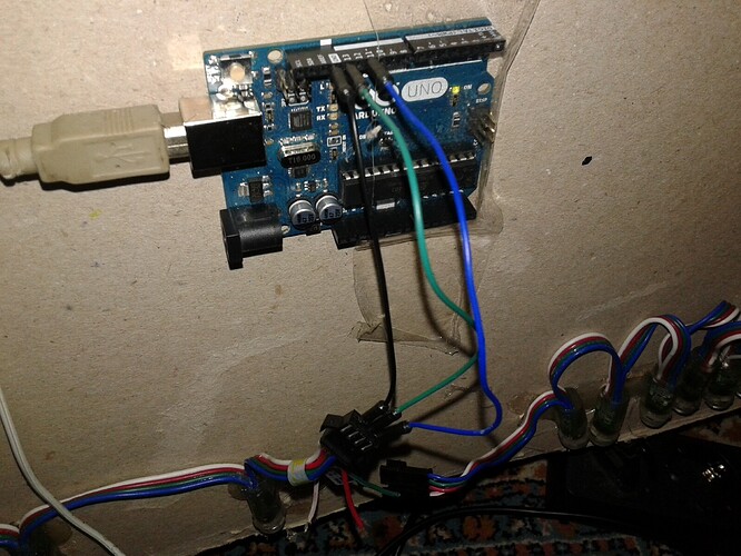

Adalight /Arduino 120 LEDs problem
80 LED is working properly
120 LED lights up randomly
setup
5v 30a power
issue
Please help
This code installed
This code installed

Assuming your problem is the flashing lights you must find out where this is comming from. You need to know if it is data varying from the screen monitoring code or is it the arduino introducing the instability.
Therefore you need to print out the data you are getting before feeding it into the Arduino to see if this is stable.
Any code you post must be in code tags.
tested normal working ?
Fastspi testleds example.
Try this with 120 leds.
Test to see if your LEDS work correctly.

Grumpy_Mike:
Why have you not done this?
Grumpy_Mike:
Have you done this?
