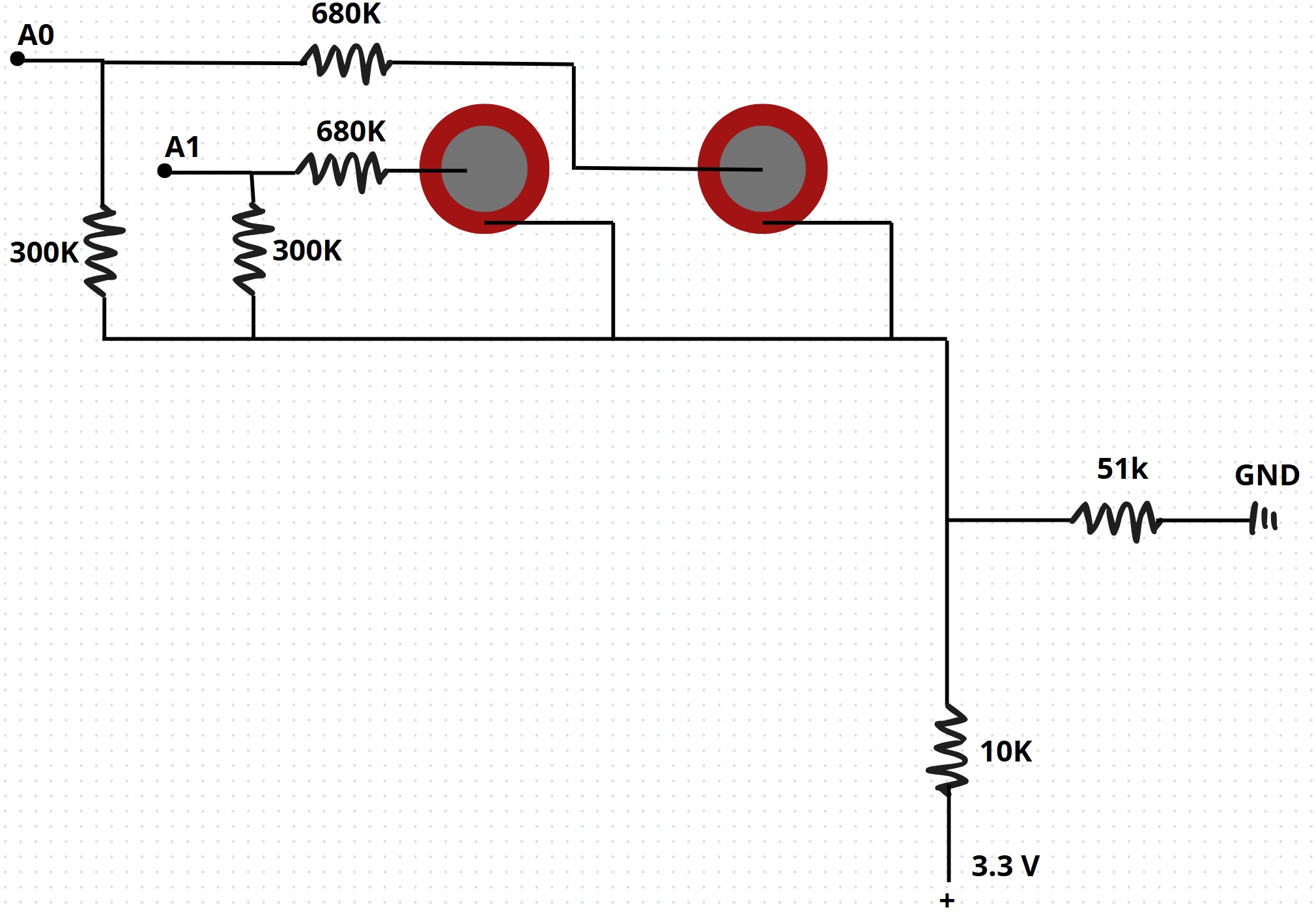

Hi There, I am using an Arduino Portenta H7 to sample analog signals. Currently, I am testing with two piezoelectric sensors, but I need to use eight. I require very high sampling frequencies, around 400 kHz. These frequencies can be easily achieved using the <Arduino_AdvanceAnalog.h> library. This library allows leveraging the DMP and reaching very high sampling speeds.
The problem is that when using two pins that are read by the same ADC (there are three ADCs), the pins interfere with each other in the measurements. However, if I use two different ADCs, meaning one for each pin, I do not encounter any issues.
I need to be able to use multiple pins on a single ADC and read them sequentially because I have eight sensors to connect, not just two. I have read that the issue might be hardware-related due to improper resistor usage since the capacitor in the ADC’s Sample & Hold system is charged too slowly.
I have used the same sensors and the same configuration as a research paper published online. Can anyone tell me if the problem could be the incorrect resistors used, or if it is something else? Unfortunately, I am a mechanical engineering student and do not have much knowledge of electronics, but I need this for my thesis.
I am attaching a photo of the wiring diagram I used. Thanks in advance!
Those resistors ar pretty big. So filling the capacitor takes time. And your sampling rate may be faster than that time...
Smaller resistors may help. But piezo sensors are also high impedance...
A buffer opamp may provide a solution (one per piezo). Some opamps come with 4 pin one IC (quad opamp). That could make things easier...
You could try to calculate the time that is needed to fill the capacitors... but I cannot find the value of those capacitors...
Thank you very much! I'll study the use of the buffer opamp since it's the first time that I hear it. I'll also try to decrease the resistors. Another move that I've tried as debugger is to decrease the sampling rate untill 1kHz and the problem was still there. At 1kHz I've found the solution putting a very big resistor (2.2M) between the Analog pins and GND.

Page 185 shows the impedance of the device driving the input to the A to D converter. Range is from 170 Ohms to 26500 Ohms, so way lower than you have. A buffer is essential for proper operation.

You already have 351 k to gnd. So adding a 2.2M resistor should not change anything. If it does: carefully check your setup for loose contacts...

It's a long time since I needed an Op-amp. I have a box of TL071s, so if I were doing this I'd use those (or TL072, which has 2 in each package). You need a high input impedance, the TL071 etc has JFET inputs so it probably going to be OK. Otherwise search for one with MOSFET inputs.
@johnerrington has a good tutorial about op-amps:
In particular look at part 3 of his tutorial, the unity gain buffer is probably what you need.

Your divider network is equivalent to 2.76V R 8.4k ; that really should be in the centre of the voltage range for the portenta adc to allow for positive and negative swings - assuming the pressure is not unidrectional.

Your resistor values are not as shopwn in the paper.
In particular, what is the value of the unmarked resistor? I'm color blind so it would be a guess -maybe 15k? Its NOT 51k.

Sorry, I forgot to use the acronym of PLA (Polylactic Acid). From the resistors point of view I know that they are not perfectly equal but I don't have 820k and 18k (the resistor without value in the paper) in the set of resistors that I have. The closest resistors to 820k are 680k or 1M, and to 18k are 22k or 10k. I thought that small differences were not a very big problem.
Your diagram shows 51k
If the fig shows 18k you should use 22k, not 51k.
what are you using for 300k? its not a common value.

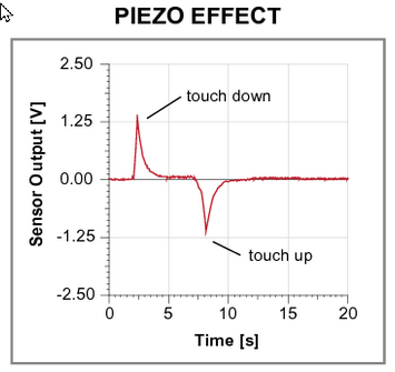

This "graph" points out a problem you may have to provide some protection against.
Its a very poorly presented graph, my Uni lecturer would have me drawn over the coals for not providing units for the axes,
However, note the input sample goes below zero, with a piezo element as small as yours, it is possible to produce more than 5V peak to peak output, in fact hundreds of volts if hit hard enough.
You need to provide some diode protection to the Arduino analog inputs even though you have potential divider networks.

Yes in the figure it's 18k but since there were problems I tried more than 22k to check if it could work. I have 300k resistors so I can use the same value for them.
