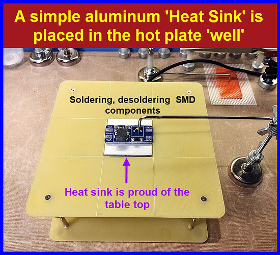

When reflowing PCBs in a DIY reflow oven, I'm encountering issues where solder bridges are forming beneath SMD components, making it difficult to identify the faulty location. What could be causing this problem, and what steps can I take to prevent or address it effectively?

  • You may have better luck with using a hot plate with a hold down clamp therefore get better PCB contact with the hot surface. As seen below.
Are you using a stencil? Some of those components look like they have a LOT of solder.
