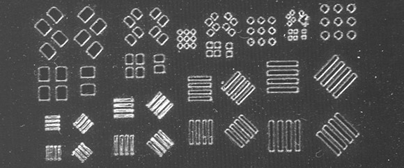

I posted about an article that also allows you to use a vinyl cutter and gerber files to make your own solder masks as well
lay down the stencil
smear your solder paste
remove stencil
populate board with components..
throw it in a cheap toaster over @ around 200+ degrees... and wait for 3-5 minutes.. waiting for the paste to re-flow.
The solder will get 'dry' looking... right before it melts and gets shiny.
Good reads:
http://dangerousprototypes.com/blog/2013/05/17/cutting-stencil-using-a-silhouette-cameo/
http://www.idleloop.com/robotics/cutter/
This script/project is by: Peter Monta
http://pmonta.com/blog/2012/12/25/smt-stencil-cutting/
http://dangerousprototypes.com/2013/05/17/cutting-stencil-using-a-silhouette-cameo/
https://www.dmstudios.net/?page_id=14
https://forum.arduino.cc/index.php?topic=365863.0
(ie: shrinking pads: first couple lines)
Making Kapton Stencils at ADX Portland using Eagle PCB.)
Boards made using the above gerber2graphtec approach.. and a $17 toaster oven:
Stencil:

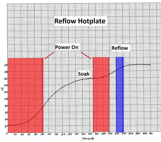

I did a hot plate project for U.S. makers using the $10 Walmart hotplate and a circular saw blade.
But I have to point out that when you go from hand soldering of SMD parts to an oven or hot plate, you then have to deal with solder paste. It's difficult to avoid putting on too much paste, and the way to avoid that is to use a stencil. In many cases, by the time you order a stencil, work up a system to mount it, order solder paste (which has a limited lifespan even if refrigerated), and then place all the parts, it may end up being more trouble than just hand soldering. Of course for some parts you don't have a choice, but it may be that specifying packages that are easy to solder by hand works well enough.
Anyway, here's the hot plate and saw blade. It's based on the idea of turning the element on, then off, then on again for specific times, which turns out to be very forgiving. That's as opposed to trying to measure temperature with a thermocouple, which can be a bit tricky and lead to scorching.

wvmarle:
For the actual soldering I've used a basic reflow oven or hot air; the first works a lot better but requires me to travel to my local makerspace. Looking into the hot plates, they're pretty cheap. Very interesting as my volume doesn't warrant a reflow oven (it's simply too bulky) but a small hot plate is really interesting.
The thing that's unique about a hotplate is that the temperature response is very much delayed with respect to turning the power on and off. (See attached chart.) You turn on the power, and it takes a while before the surface starts to heat up. You turn off the power, but the surface temperature continues to increase for quite a while. So there's really no way to control the temperature in real time. You have to figure out in advance what on/off pattern produces the right temperature profile, and then follow that timing each session. Or, if you don't want to bother about soak periods and such, you can just turn on the hot plate, then remove the board (not just turn off the power) when the reflow has finished.
