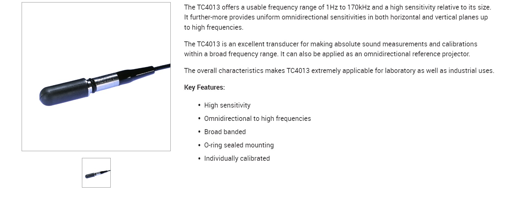

As a newcomer to hardware, I have received a hydrophone (TC4013 - photo attached) to collect response data and intend to purchase an amplifier for this purpose. However, I am uncertain about how to connect these components to the Arduino board and whether any additional components are required. Could anyone please advise me on this matter?
Welcome! What is the question. From what I see with the information you have given I do not think you will be successful. It appears the output is RF and the Arduino's are not capable of that as a standard digital input. I believe you will need some type of analog to digital interface. Show a preliminary schematic as to how this is to go together, also some of your work on how they are to interconnect and what you expect as an output. Post links to Technical information on the hardware, not just sales information. Try this link: How to get the best out of this forum

Pulling the PDF does not give me any hint on what "value" Arduino would play in the system:
My project aims to locate the location of a pinger and direct the surface vehicle towards it. I am not sure what I meant by "collect response", I only know that I need some sort of response to determine the time difference of arrival of the signal at multiple hydrophones placed at known positions. (I am very new to signals, hardware, and software. Quite lost as to where to begin.)

The devices you linked to are strictly AUDIO, up to 1 mHz audio. I cannot conceive of anything an Arduino of any type that would be able to do anything with that range of audio signal. What actual audio frequencies are you interested in?
From my previous (lite) research to arrive at my previous post, these devices are broadband primarily to ensure a flat frequency response underwater. In actuality, actual hydrophones in-use, have a much more narrow characteristic:
