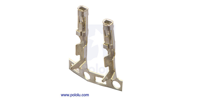

http://www.pololu.com/catalog/product/1801 and splice your ribbon cable to it, leaving the female ends free to slip into the housing.

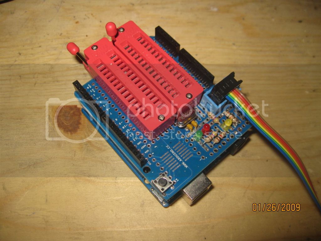

No, I'm using my UNO as a programmer/bootloader. I posted a thread about it here: Arduino as ISP shield project - #7 by system - Project Guidance - Arduino Forum
Now I have to use 5 jumpers from the UNO to program my standalone project and it's a little cumbersome plugging/unplugging them when testing sketches. My idea was to put a 2X3 on my UNO and another on my project(s) and use the ribbon cable for programming.
I would like to do the pinout in a logical manner so if I get a proper FTDI device in the future I can make a cable that will go from the 2X3 plug (On my projects) to the straight header deal that most FTDI devices use.

I'm using the shield with the ZIF sockets to bootload the chip. I didn't think I would have to deal with that anymore once it was done so I was only concerned with programming once it was put together. Should this be a problem?
I also figured I could make an adapter cable in the future if I went with an FTDI programmer. A little cable with a straight header on one end and a 2X3 (Or is it 3X2?) plug on the other.
