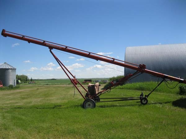

The picture is kind of a bad example of what I am interested in. The auger in question is an “8 inch” Sakundiak auger used for wheat. The grain falls straight down and has no horizontal component.
Modern harvesters do this but I am looking for auger usage like the one in that picture I will attach. The area will have porosity in it so this will have to be an experimented value that I will have to make an assumption and multiply this porosity by the area recorded.
