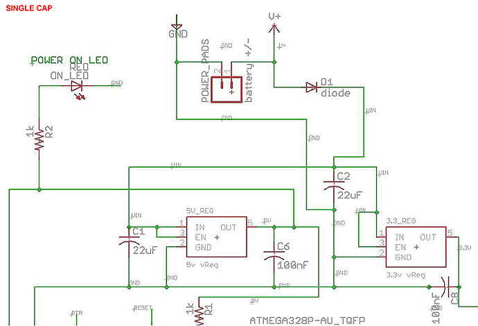

I got to thinking about one comes to the 'values' of caps used for decoupling their power lines/rails..
read some threads.. and came across this: "That is why you have to use both a small cap 10 to 100 nF in parallel with a big one 10 to 100uF."
I went back and looked at a schematic I made (and posted for review).. and noone seemed to point that out to me on this project??
How crucial is it to have TWO caps in parallel on the regulated lines from the vReg?
(and Im not thinking that 22uF is WAY to big to have a cap on the input of the vReg lines?)
So for this diagram/schematic..
1.) Is only having the 1 cap (100uF) after the regulator 'ok'? ...single cap? (doesnt match the statement made above though?) (I just ordered the PCB's too!) LOL
2.) Im thinking 22uF is way to big of a value to use? (C1/C2) should I knock it down?
Depends on what the datasheet for the actual regulator says. Most will work with 1uF on input and 10uF on the output, but best to check what the datasheet says, especially for low-drop-out regulators (much more fussy).

that is 'faulty'?... and will not work as is? or just be 'slower' (slower for what? to power up?)
but if I need to make changes and re-order...I'd guess I'll have to do that.

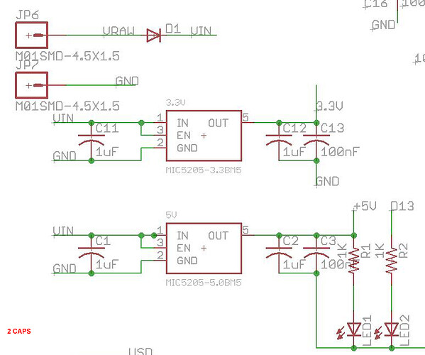

Should I just mimic the layout/schematic like in the second image then?...
This forum is totally screwing up lately - I wrote a long post, and it ate it. Short form,
the 2nd image is what you normally see.
you always need both electrolytic and bypass caps on the Vcc buss, although a bypass on the uC
Vcc pins will probably be adequate if not too far from the v.reg.
if the electrolytics are too large, Vcc may come up slowly, and the uC may not boot properly,
but you'll probably not have that problem with values of 1..22 uF.

there is no Electrolytic caps even being used (guess that is in incorrect).. I didnt see any +/- in the schematics..where others 'did' have it

so to use a ceramic cap is not enough.. or not 'correctly' decoupling the power lines...correct?
it 'must' use a electrolytic cap.. (for the polarity)..
