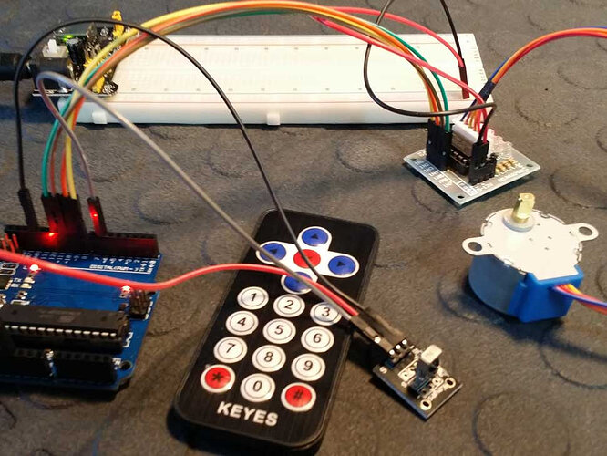

edit: It has come to my attention this image does not have "IR Remote"... I wrongly assumed the the A4988 was the issue... I also do not like the "solderless breadboard" with a motor. I should have used the second link in the search (rather than the first link) to show IR Remote with motor controller and stepper.
... And... this link was just to show that the internet DOES have parts of the request, and even the whole bundle. I am certain if I did some picking and choosing anyone could find a drop-in-replacement for hardware and code. That is why I said "No, you did not search."

hi mate thanks ive been going through all the tutorials etc and im getting there slowly lol but i have this little project that i need to do so thats why i am asking for a wiring diagram image would be so much easier
i certainly have searched and quite a bit mate. i aprreciate your diagram i have seen loads of them but not seen one that includes a ir remote sensor , a4988 and uno altogther
brilliant mate thanks . yeah ive been searching like mad lol. im not new to electronics either just this arduino thing is new to me lol but im learning fast
worked an absolute treat mate thankyou.

hi mate its cool ive got it sorted ive watched that tutorial also thats for a 5 volt stepper motor not a 12v but ive managed to get it working perfect after some help from someone on here and its all good .
