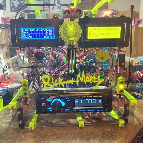

Nice setup. Straying OT, but what are those two partially visible units, bottom right, with blue and red displays.
Your printer looks like mine. An Ender 3 V2?
Its one of my Arduino prototypes.
Yes, its a Creality Ender-III. I make tons of stuff with it for Arduino projects. Mounts, feet, cable shrouds, etc. not to mention medallions, Rick & Morty stuff, etc.

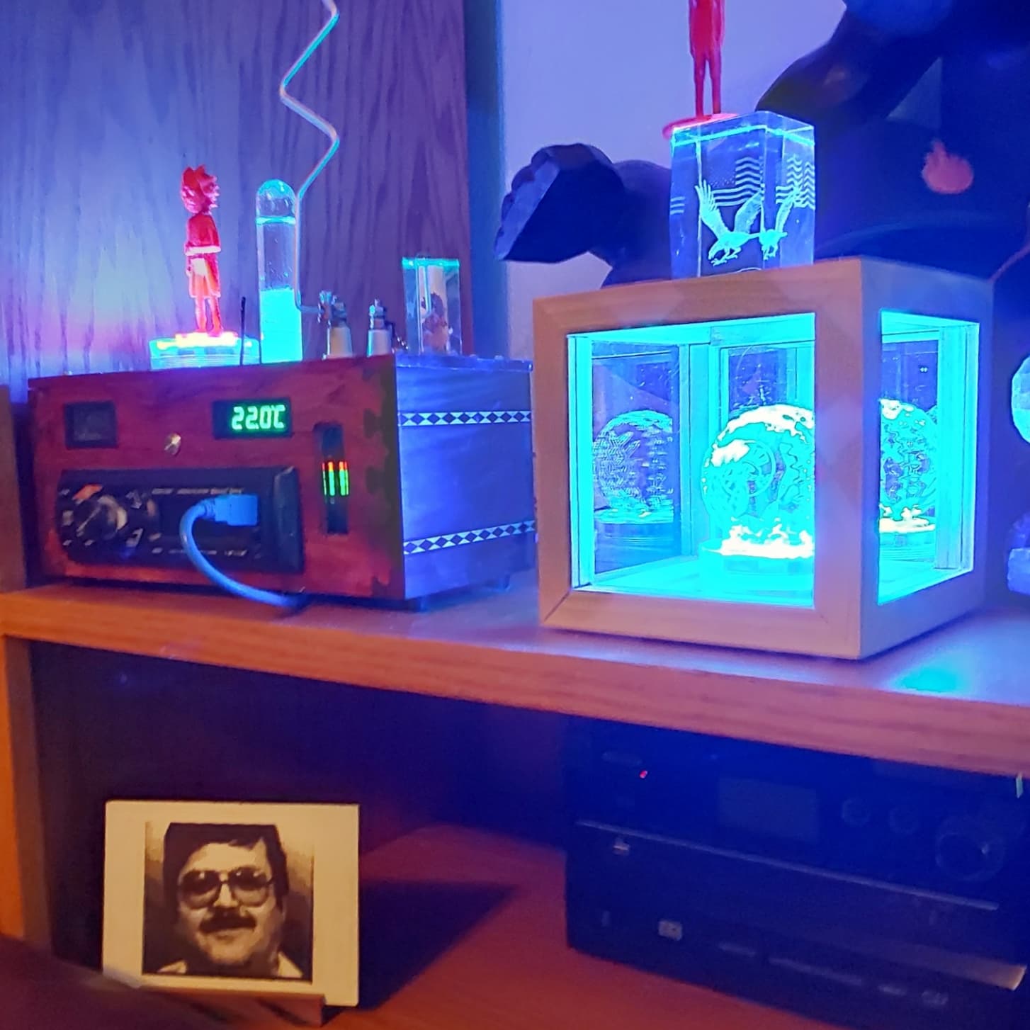

It was my first project as a test bed for everything I could think of. It was supposed to be "steampunk". Check this one out:

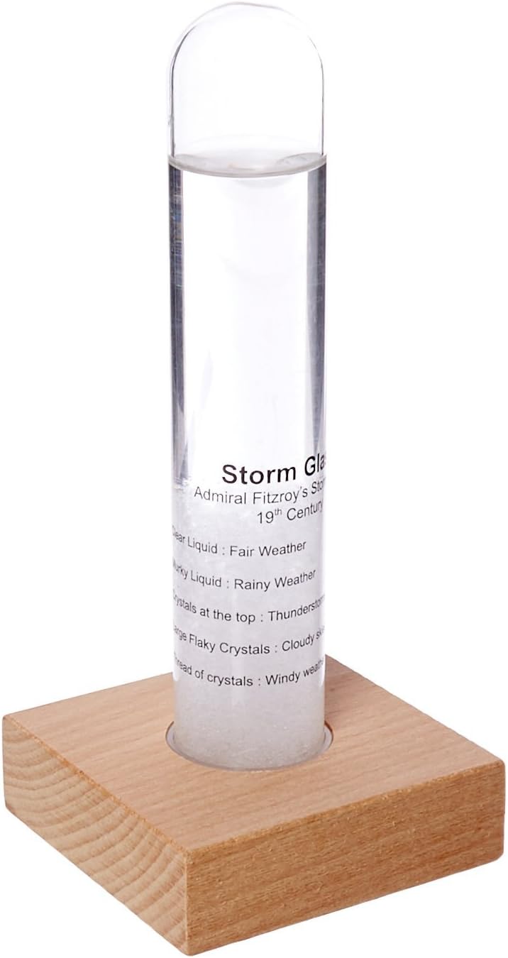

What is this magic turquoise something filled ampoule?
Its a "storm glass". The lighting is color change LED controlled by the push button switch in front of it.

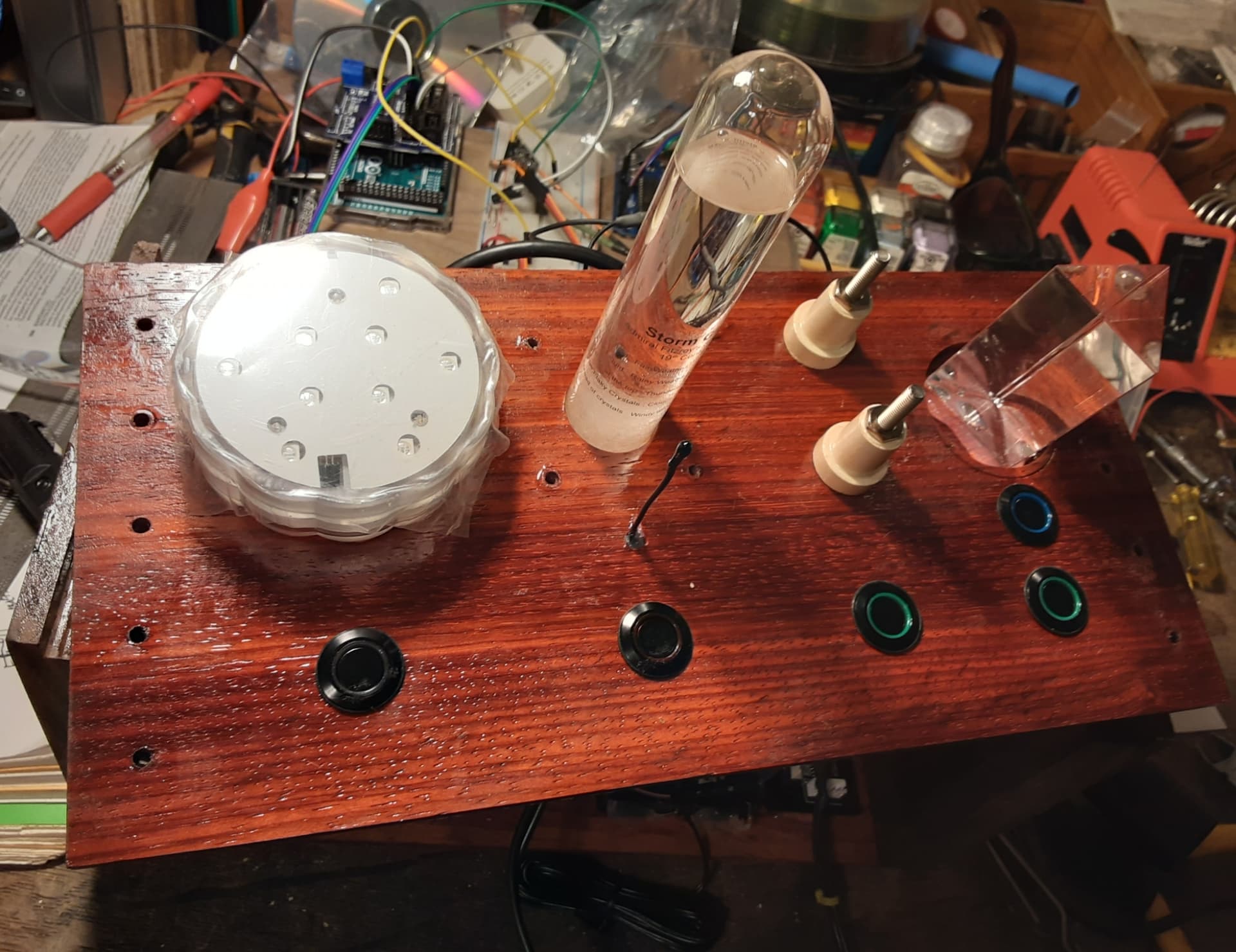

There is a lot of joinery in the box: Inlaid racing stripes, beveled face plate, ornate dovetails, recessed lighting, and exotic woods.
I made the glow cube too. The laser image is me, back in the day! LOL
Wood shop dovetails nicely with electronics shop for project packaging.
This is actually on topic, because of the multiple rectangular cutouts in the faceplate! Drilled, scroll sawed, and sanded for final fit.
  • The two electrodes are a vertical FM dipole antenna with the zig-zag for coolness and a beaded chain as a ground wire.
  • The led "puck" light was converted from battery to hard +5v power. The 3d printed Rick is on display.
  • The dark rectangle is an LCD humidity meter.
  • The green display cycles time, temp (sensed by black thin probe in front of storm glass), and DC voltage.
  • The car radio is Bluetooth and drives 4x speaker terminals on the rear with 50W.
  • The vertical LEDs are a VU meter with selectable display modes (selected by small chrome button centered over the radio.)
  • Each gadget is separately controlled by a series of lighted push buttons on the top.

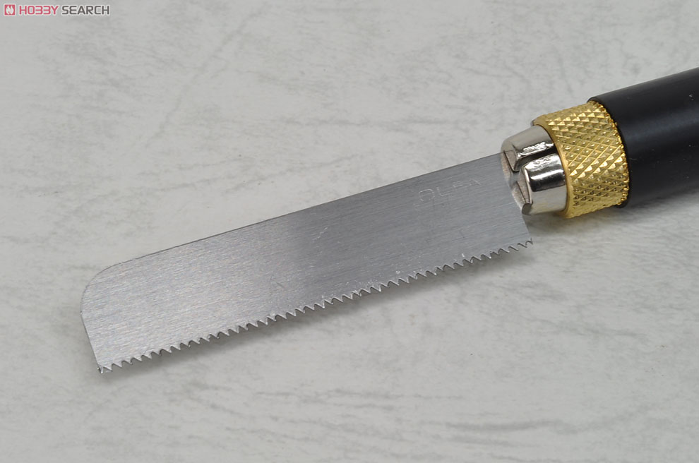

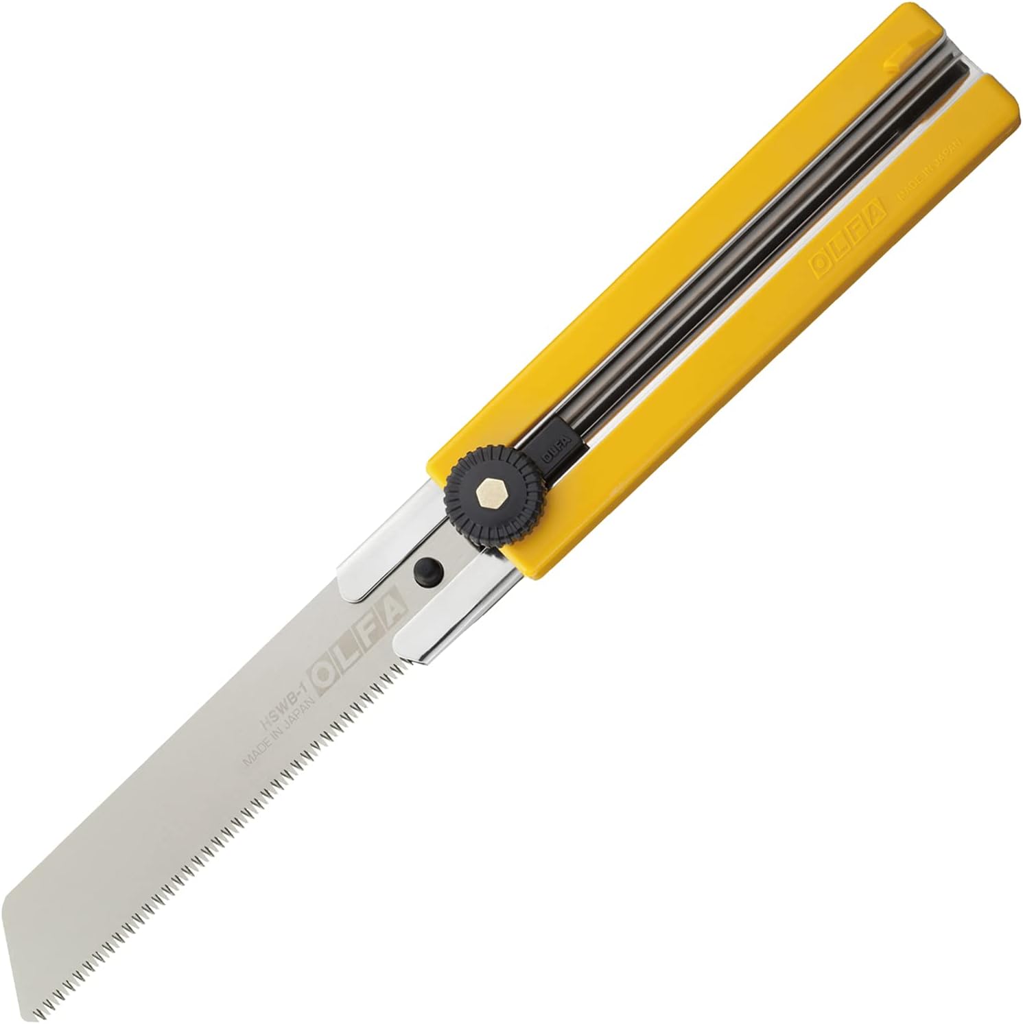

Another option is to use one of two the available saw blades available for an Olfa Ak-4 handle.
You will not be sorry you invested in these, must have !
These are extremely sharp and aggressive and make short work of a required squared hole.
Use these slowly and do not over force the blade while sawing.
A bit larger, these are great too.
I have a similar saw I bought a long time ago. Strongly recommend for small, precision work.

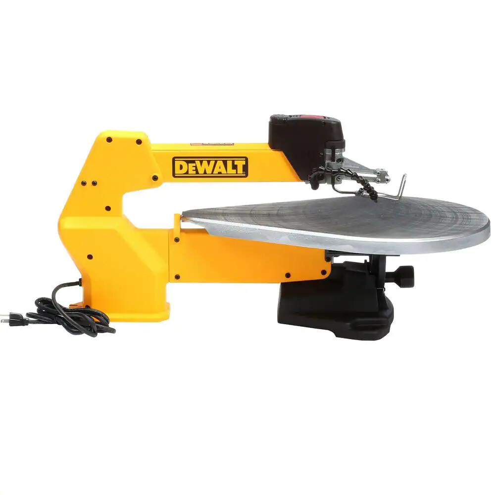

So would a Scroll Saw set to slow and using a metal cutting blade.
