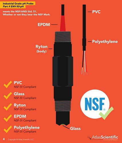

You could also perhaps look into stainless steel food industry pH sensors like this one with +- 0.1 accuracy
When it comes to food, especially food INDUSTRY, make sure you have certified good grade probes for any sensor that touches the product.
Thanks to last 2 comments, but I'm not measuring the pH of the corn, I'm measuring the pH of the water used to wash the corn, to make sure it is slightly acid
Still. pH sensor in direct contact with water that is in direct contact with the food.
Check your local government's regulations, very likely it will state it must be food safe. Just like the pipes that washing water is running through, as any contamination there will end up in the corn just the same. Even if not in the regulations, it's just good practice.
Ok, yes now I understand.
Hopefully this is what you are talking about: See attached image
