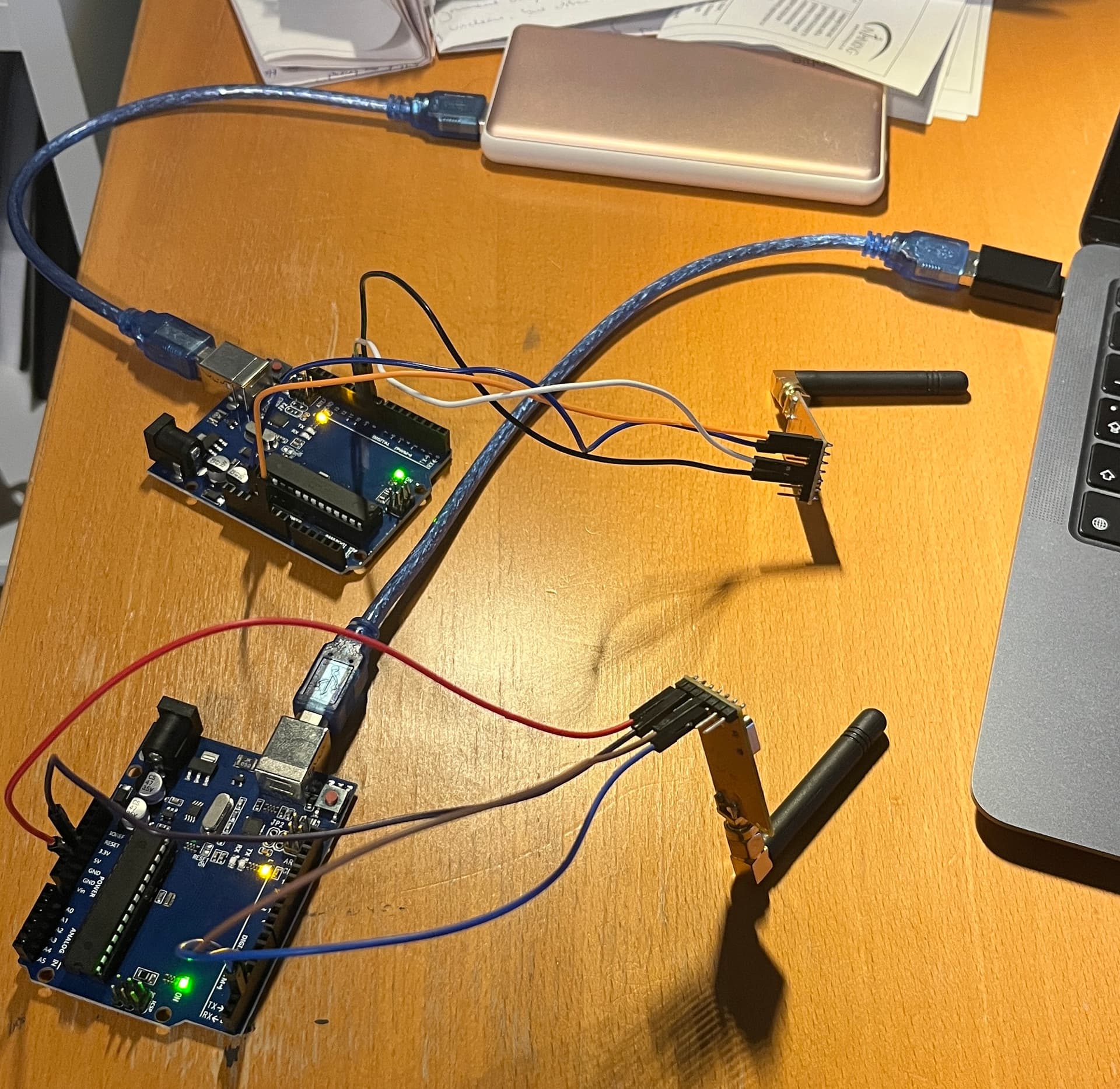

Hello,
I am using a pair of APC220 modules to communicate data from sensor from one place to another using 2 arduinos. I am currently learning how they work and am trying to send a string from one apc to another. However, this doesn't work. I assume that the APC220 is sending data, because the tx lamp is flashing, however on the receiving arduino i do not see the rx lamp flashing. I have checked the wires and checked if they both have the same settings. Does anyone have an idea of what the problem could be?

Looks like you have the pin assignments backward.
SoftwareSerial reference page
Powering a transmitter from the controller may be a reason for trouble. It's bad design using the controller as a power supply for motors, transmitter etc.
If You're lucky if things just don't work. If You're unlucky the controller board gets damaged.

I have changed the code for it to match it correctly, but still no luck. serial monitor doesnt show anything
Triple check the wiring, too.
the APC's rx goes into the arduinos tx and the APC's tx goes into the arduinos rx correct? I have checked the wires over and over again, seems like everything is correct.

Changed the code, still dont see anything.
https://www.circuits-diy.com/interfacing-apc220-rf-transceiver-module-with-arduino/
The problem is fixed! I have switched to 2 brand new arduino's and new jumper wires. The problem was probably in one of the jumper wires, but im not sure.
