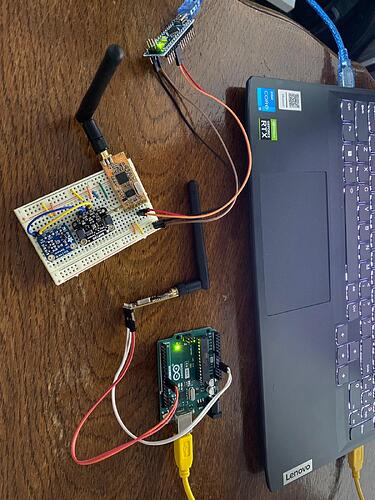

I have 2 APC220 radio module, one connected to an Arduino uno R3 that transmits data, and the other one connected to an Arduino nano that should receive the data. I see on my uno that transmission is working, but i do not receive anything. I also tried to use as receiving only the radio module connected to the pc, but i don't receive anything (I used cool term for serial reading). The configuration of the radio modules i did in the Arduino, they are both configurated the same. I can't see what is the problem.

There is nothing obviously wrong with your code, but you forgot to post a wiring diagram, and photo of the setup. Did you connect the grounds?

i'm so sorry, but i don t know how to do a schematic, yet.
But i can tell you that the Rx, Tx from the module are connected to the pins specified in the code (rx - 9, tx - 10 and, rx - 2, tx - 3), gnd to gnd and vin to 5V. Here is an image with what I have.
It is the internationally accepted and understood language of circuitry, and very important.
After reading this brief tutorial, draw one with pencil and paper, using rectangles and lines, labeling each connection. Take a pic of it and post.
The photo is not useful as it does not clearly show the connections. Something like this, but clearly show power and ground connections.
Note: you need to connect TX on the module to the pin designated "RX" on the Arduino. Follow the instructions on the DFRobot site.

Never mind, It's working now. I had a problem with that delay(20), i put delay (1000), and with the modification of the pins as you said rx-tx, it now works. Thank you so much. :smiley:
