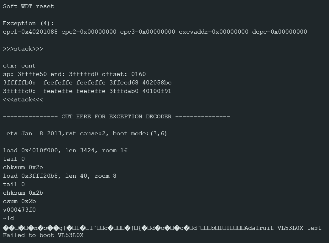

So I connected VL53L0x ToF sensor (It should be APDS9900 APDS 9900 Proximity Sensor) to my ESP8266 board with this configuration: SLC to D1, SDA to D2, VCC to 3V3, and GND to GND. Then I tested it using I2C Scanner and it found a device with class 0x39 which corresponds to my sensor. But when I used the adafruit example sketch for VL53L0x, it gives error said the sensor isn't connected. Below are some documentaries for this post:

  if (!lox.begin()) {
    Serial.println(F("Failed to boot VL53L0X"));
    while(1);

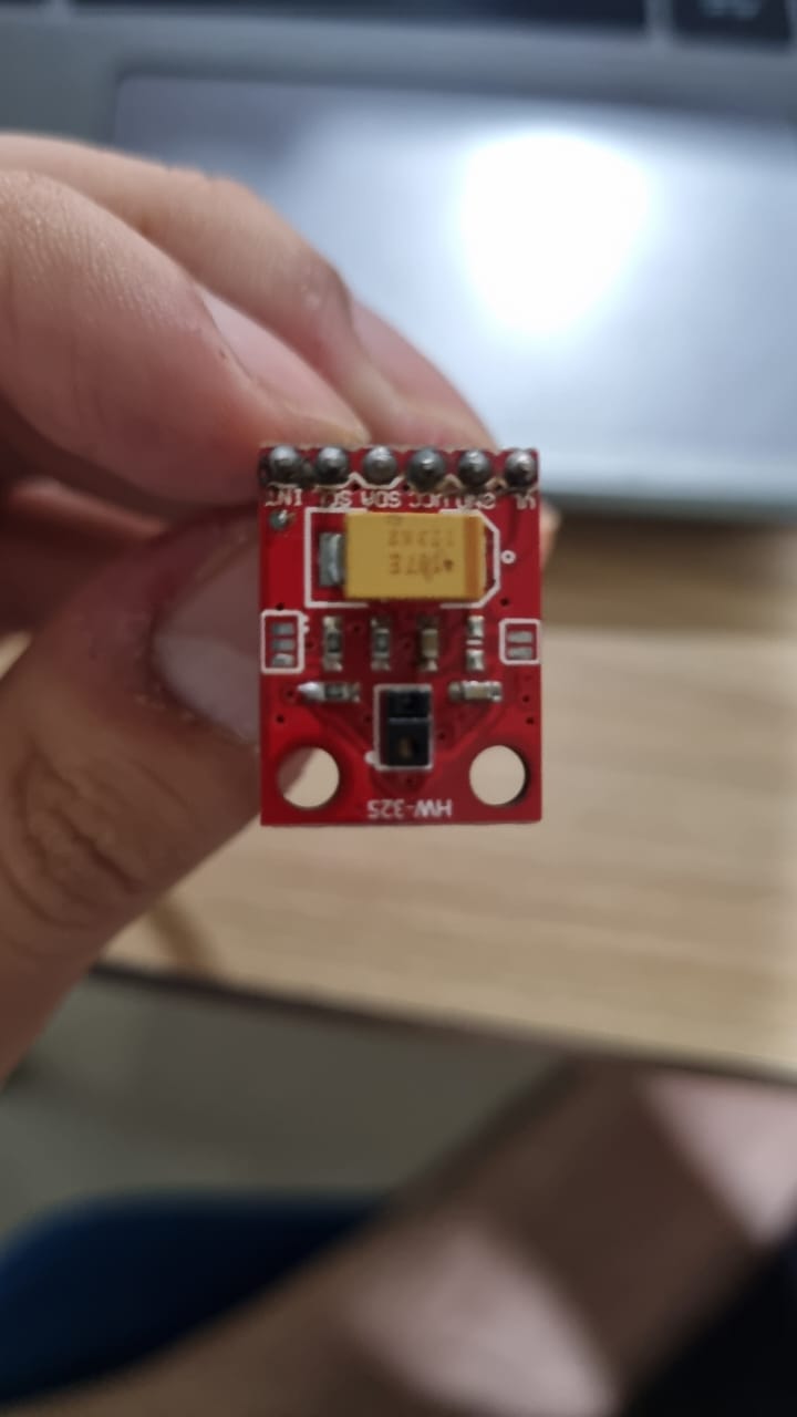

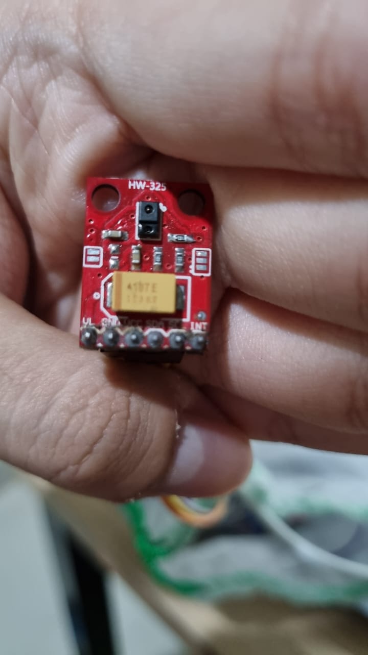

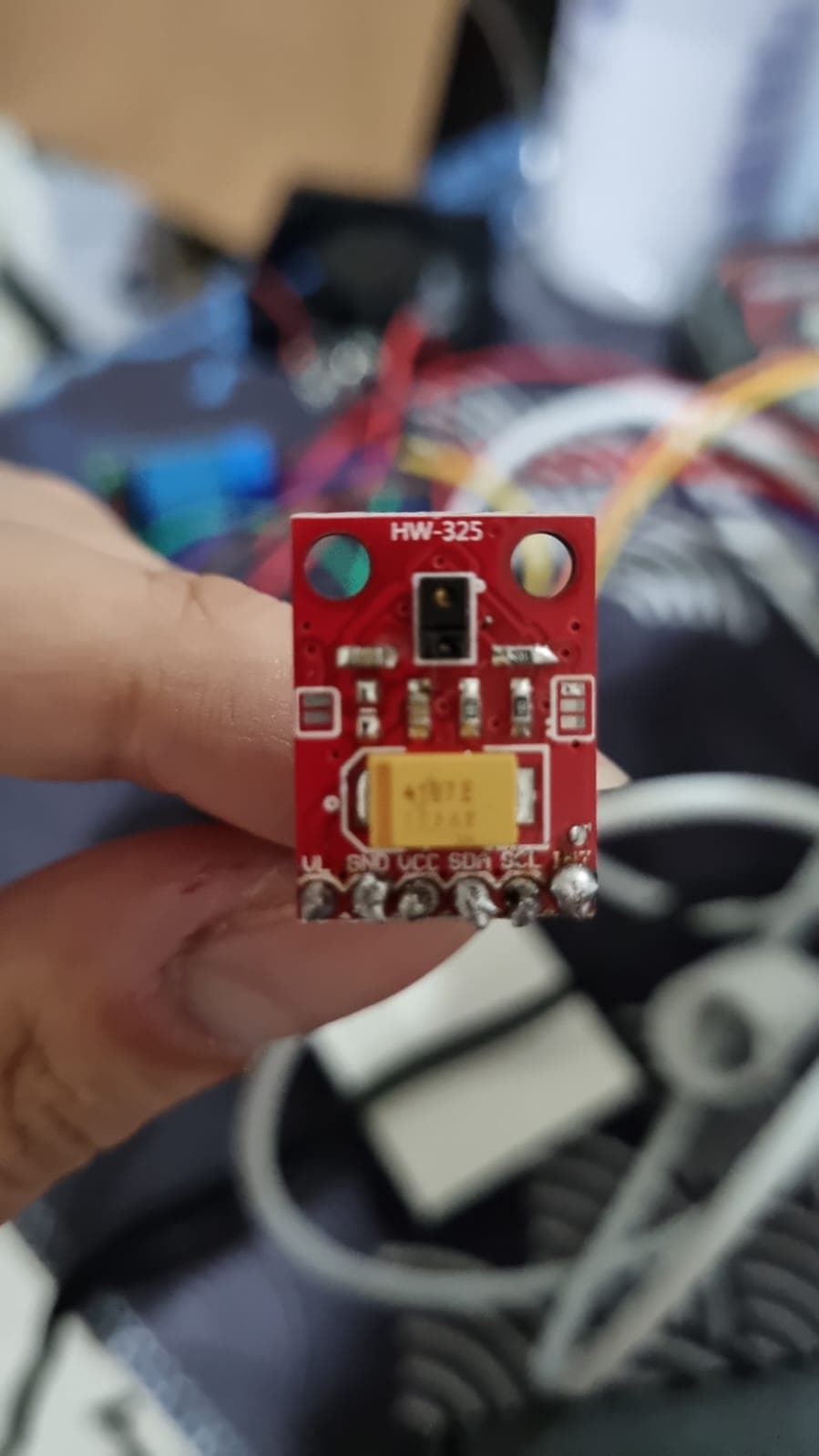

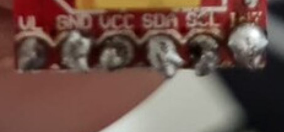

The problem could be your soldering.
VCC of the module is definately a cold solder joint.
Leo..

This is really bad. You need to remove all the solder and do it again.

You keep bombarding us with code and ignore the fact that your soldering is bad.
First show us your corrected soldering, then we might look at the code.
Also tell us if and what kind of flux you have used.
Leo..

Sorry guys, I have corrected the soldering since 5 days ago when
PaulRB gave the advice. Here's the current state of our soldering and I think its better than before.
