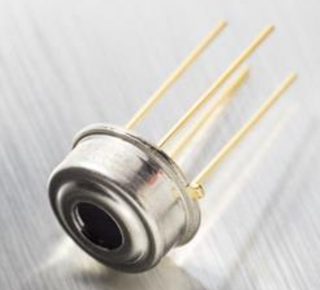

There are 2 models of this sensor.
One for 3V and one for 5V.
What is your model?

we used the 3V model

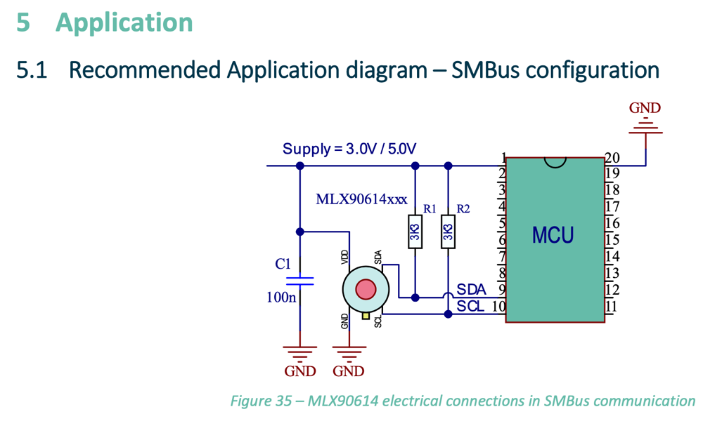

Maybe you missed the 10kohm pullup resistors (on SDA and SCL) ?
I think the module we used already have built in pull up resistor for its SDA and SCL, it said that 472 on each pin

4K7 ?

The following diagram is the recommended circuit from the datasheet:

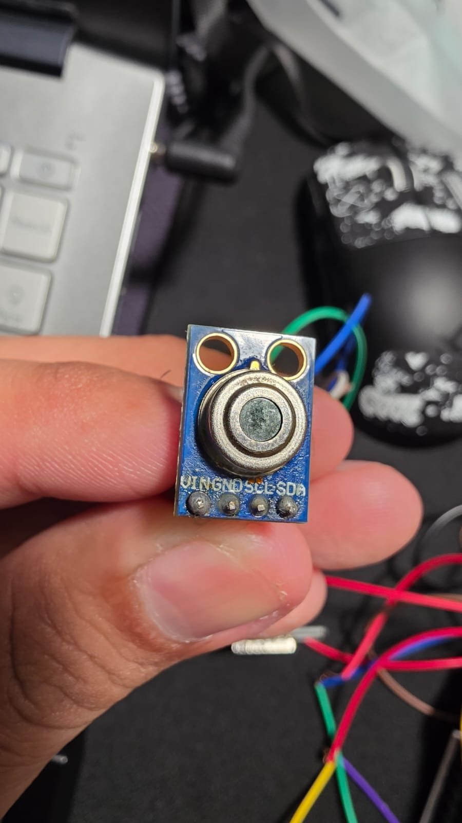

Those are our wiring for ESP8266 to MLX90614 where the green wire connects SCL to D1 pin, blue wire connects SDA to D2 pin, GND to GND, and VIN to 3V3. Is there any miscofiguration about this? We have tried to use other codes, but still the I2C scanner found nothing.
Thanks for the photos. The connection looks good. However, your sensor is not a new one and the solder seems to be oxidized.

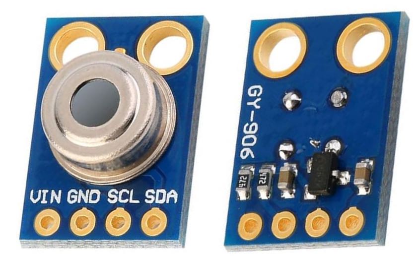

The following is a photo of a sensor I found on Amazon that I believe is the same as yours:

    I don't know the length of the BLUE and GREEN wires, but just to be sure, you should check each terminal with a DMM and check the wiring to the ESP8266. You may find oxidized solder defects. In this case, you may also need to re-solder.

EDIT: Your sensor breakout board appears to have a regulator on it, so you should probably provide 5V to VIN.
