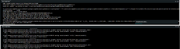

Let me show You the problem:
When I start compile output window displays upper picture, but after few seconds it dispappers and it looks like down picture(some logs with other compilation massages).
You currently have scroll-lock on which might be the cause of your issue. Click the lock icon at the right hand side of the output window so it looks like below.
It doesn't matter. When scrolling is on or off, starting messages are lost.
I think You're right. There are some output log limitations.
There is. As you guessed, it is 1000 lines. This can be adjusted via the advanced settings:

Thanks a lot. That what I was searching for. I changed setting to 3000 and now displays all logs.
