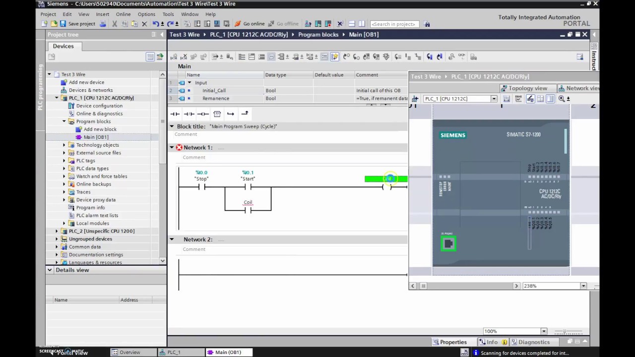

I am using Simens S7-1200 simens PLC from long time.Now i am trying to build own PLC software which uses arduino hardware . Kindly suggest me suggestion for supporting hardware and software to be procure to getting started.

I wanted to give Front end where user can use function like
Timers,Counter, Math,Logical,IO communication related tags . Where user can drag and drop for end application. background will running code written in C/C++ based on application.
kindly recommend hardware and Software for this application.
