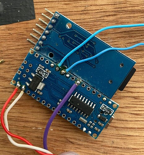

I would like to use for a project several arduino boards with an sd card reader. I have been using for this purpouse Arduino nano + SD card reader as seen in the picture.
I am wondering if there is an Arduino board or similar which already has an SD card reader incorporated.
