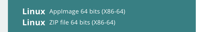

I just got an Arduino Nano, but impossible to use because my computer is running Ubuntu under AARCH64. Ye, kinda sad. So i checked and theres no officials clients for this architecture, but i discovered : Arduino Cloud (: . Only problem (ye ik theres much problems), it asks me to download the Cloud Agent HTML file, and place it in the application folder, but i really dont know if this even exists. If you can help me, tysm (:

As i said, my computer uses the Aarch64 architecture, not the x86 one, and i wanna use the cloud editor to code my arduino
Ad i also said, i really dont know (and i think theres not) a app folder, so i wanna get some indications for where shuold i place the cloud agent in my PC

It is not an HTML file. It is a .tar.gz file, which contains a .run file. Maybe you didn't click the "DOWNLOAD" button on the Arduino Cloud Agent installation page?
But unfortunately I don't think this will be of any use to you even if you did manage to download the file. The reason is that Arduino only distributes x86 builds of Cloud Agent.
The most simple way to get started using Arduino on your AArch64 machine is to use Arduino IDE 1.8.19. Arduino distributes AArch64 builds of that version of Arduino IDE. You can download Arduino IDE 1.8.19 from the "Linux ARM 64 bits" link at this section of the "Software" page:
https://www.arduino.cc/en/software#legacy-ide-18x
After downloading the file, follow the instructions here to install it:
https://docs.arduino.cc/software/ide-v1/tutorials/Linux/#extract-the-package
If you are set on using Arduino Cloud on an AArch64 machine, you would need to build the Cloud Agent application from source. This is a somewhat advanced endeavor. I'll provide an overview:
