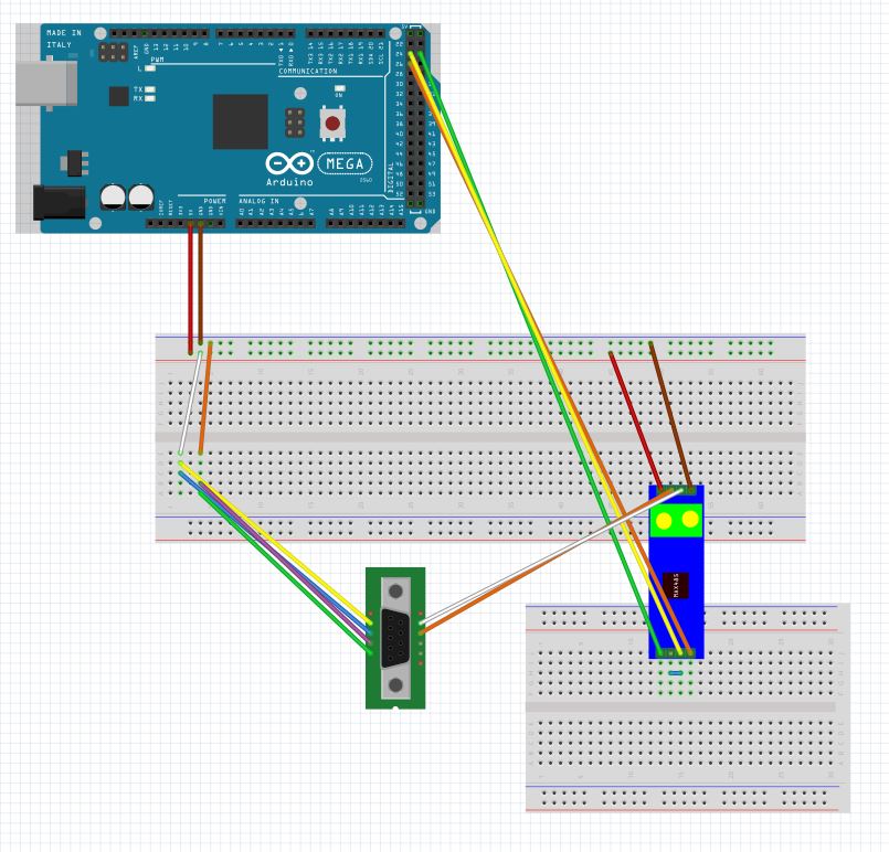

For transferring, I'm using a Max485 Chip RS-485 Module TTL to RS-485 Module (shown in diagram) with link to component below.

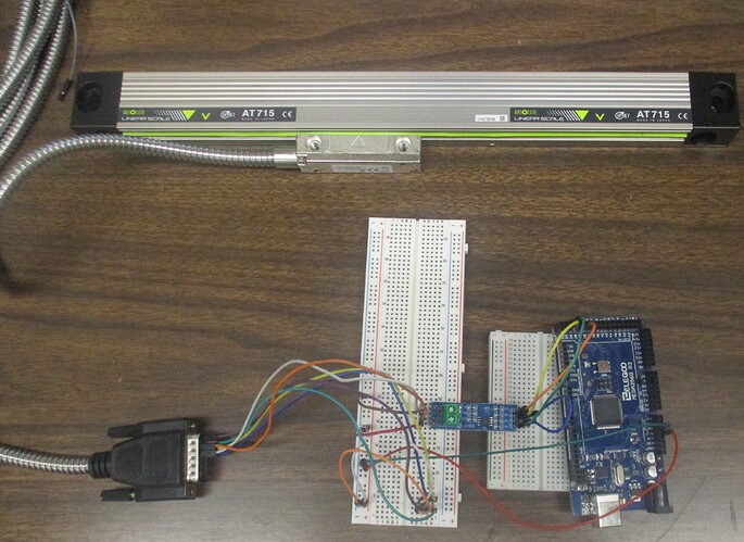

I attached some photos of what I currently have wired up and some more specs of the linear scale I found online.
I have 5v from the Arduino running to Pin 3 and 4 of the DA-15 connector as well as the RS-485 VCC
The ground is connected to Pin 1 and 2 of the DA-15 connector as well as the RS-485 ground
Pins 10 and 11 of the DA-15 connector are running to pins B and A of the RS-485 module.
DI on the RS-485 module goes to digital pin 26, DE goes to digital pin 24, RO goes to digital pin 25, and RE and DE are connected together.

The spec sheet that I have read says that I need to send it a hexadecimal value 0x00, in order for it to send its absolute position back.
According the Scale Interface pamphlet (linked below) I should be communicating with hexadecimals. With this code, the Arduino is transmitting the hexadecimal 0x00 (the code for absolute position) and displaying a 0 as being sent (per the code), however it is not receiving anything back. If I comment out the If statement it will display 255 as being received when printed.
I believe I should be receiving a data package within 15 milliseconds consisting of 6 bytes, one byte echoing the command code (in this case 0x00), followed by 4 bytes that make up the absolute position data, followed by a crc byte.
Hitherto I have not been able to receive anything from the scale.
Pic 2.
I guess you found this - it looks simple enough to get something out of it http://bbs.homeshopmachinist.net/threads/20429-Mitutoyo-Linear-Scale-AT715-signal-format It appears that it will transmit when moved. If it's not doing that, then there is something internally wrong with it. If you've not got a scope, then if you put a multimeter accross its terinals, you may be able to determins some 'flicker'. In that link, the drotechguy is offereing to help (and he was there in 2017), maybe worth a while dropping him an email.
