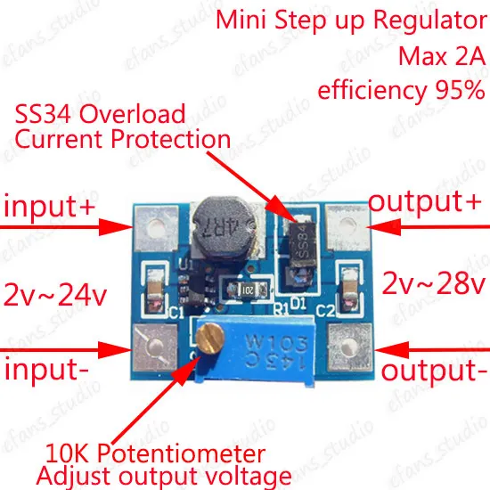

I'd like to ask, what components should I use to DIY 12V to 24V power supply?

So the current thought the valve's coil should be 4.8/24 = 0.2A
Look for a "boost" or "step-up" voltage converter module. Since only 0.2A is required, even a small one should be enough.

Ok, if you feel to do extra wiring, you could use boost converter proposed by PaulRB.
But you might find some small 24V psu laying somewhere in your house. Have a look.
something like this for example...
