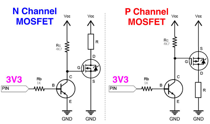

  • Drive the MOSFET gate with a BJT.

  • As mentioned, the OP could drive the MOSFET gate with a BJT.

We don't have a schematic, but wouldn't the BJT still only have the same 3.3V battery voltage to switch?
  • A BJT (example 2N2222) works on current rather than voltage.
  • And yes, we should always confirm, with a DMM, our BJT and the MOSFET
    fully turn ON/OFF.
