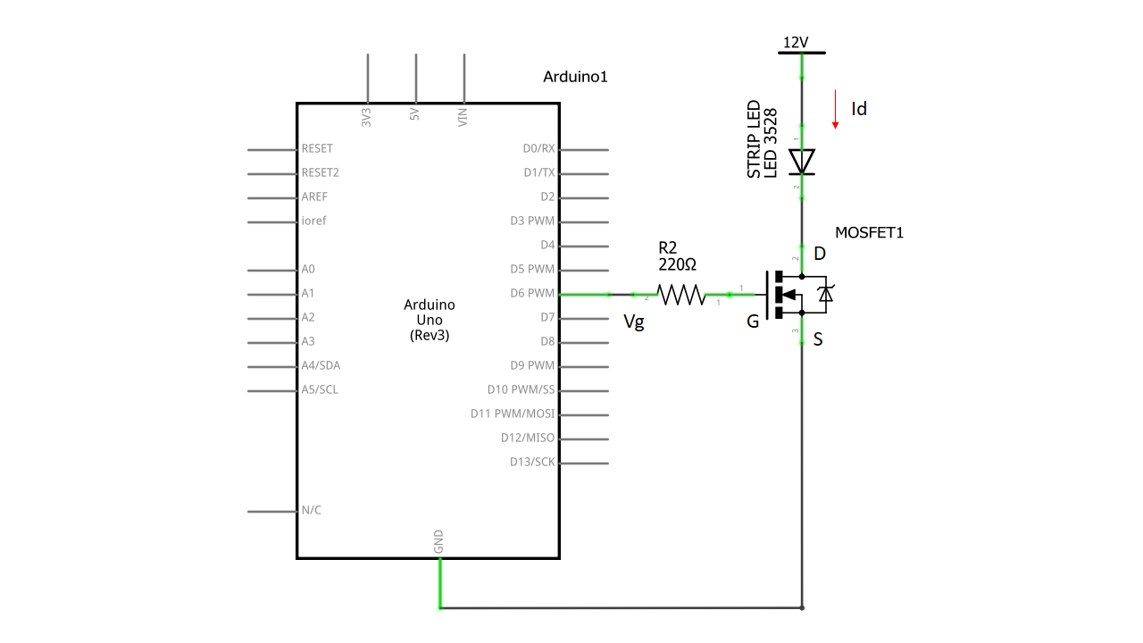

I am wanting to buy a arduino and I was wondering how would I connect the +24v , R,G,B and White to the board its self for a sk6812, I have very little experience when it comes to electronics and i dont want to blow anything on the led or arduino.
Any help would be apreciated :grin:
And to power the Arduino itself from 24V, use a DCDC step down converter.
