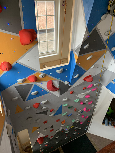

Forgot to mention that the LEDs are on a custom ordered build with 10 inches between them making it 300 x 10” = 3000” or 250’ feet in total length.

Added a photo of my climbing wall for context of what I am working with... Lighting up holds from behind the wall, but testing out that they all work.

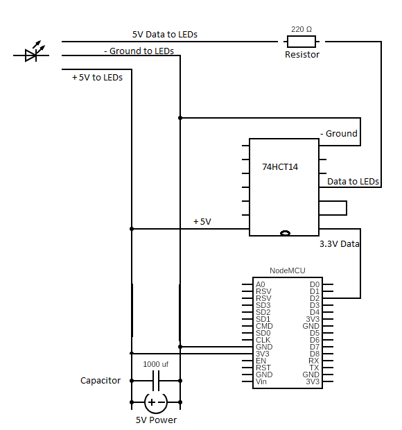

Hi Paul and Mike, I just received the chips today and have been trying to get them to work with a bit of frustration... I thought that I would be able to figure out the pin layout requirements, however this has become a bit more challenging to figure out and there really are no images or videos that show you how the wiring should be setup with an Arduino board, power and data line to the LEDs. Do either of you have an example that I can reference? Thank you in advance!
Drawn a quick diagram of what I currently have that may be working. Just would like your advice on proper wiring. 300 LEDs that are not all on at same time, roughly 30% max and no white. Now using 25W 5V 5A Mean Well - SGA40U05-P1J. Thank you.
Your diagram makes little sense because there are no labels on the parts and wires.
This is how you wire this up:-
Hi Mike, Sorry for not writing all the labels. I have completed it with labels and re-attached. Looking at your 74HCT14 diagram, I am not sure how it is wired as there are no pins like the part whereby it has 7 pins per side. The only indicator on the chip is a notch on one side indicating orientation and I have taken my best guess from the numbering and using the 74HCT14 datasheet to rewire based on your diagram. Please advise if I am correct in my interpretation(circuit(2).png). Thanks again for all your help!
Well you haven’t labelled any of the pins on the 74HTC14, and have drawn the chip upside down. You have no ceramic 0.1uF capacitor across the power and ground of the chip, and you have left the unused gates in that chip unconnected.
You are trying to draw a hybrid between a schematic and physical layout diagram and getting the worst of both worlds.
You have not even labels what chip you have, I know because we are having this conversation but it would not help anyone work out what you are doing.

That is because a lot of stuff on line is designed by idiots. I have over 50 years in this game. I wouldn’t tell you to do something if it is not necessary. You need to connect unused gates to add to the stability of the circuit. They are not doing anything else so what is the problem of treating them correctly?
When you say that "I have left the unused gates in the chip unconnected" does that mean that I have to connect them to each other as in 2A and 2Y, 3A and 3Y, etc.?
You can connect them in many ways, my circuit is just one of them. All the inputs to unused gates need to be connected to ground or another gates output.
OK, either of those will work, but you need to conenct pins 5, 9, 11 and 13 in the first diagram, or 3, 5, 9 and 11 in teh second to ground or 5 V.
