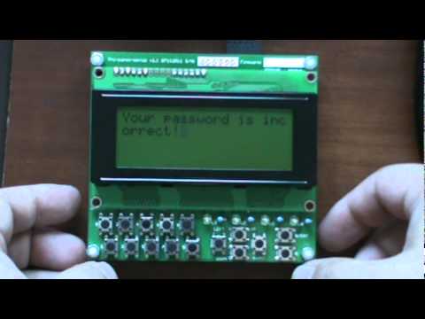

Really have no idea why such a simple task for comparing password with strcmp() requires a class but take a look at this:
I can upload a new video with the buzzer and reset code in action tomorrow. Too late tonight.
You will need a phi-panel to do this though. If you have an LCD all you need is the back pack and the panel is on sale :wink:
http://www.inmojo.com/store/liudr-arduino-and-physics-gadgets/item/serial-16x2-lcd-keypad-panel---phi-panel/
http://www.inmojo.com/store/liudr-arduino-and-physics-gadgets/item/serial-20x4-lcd-keypad-panel---phi-panel/
