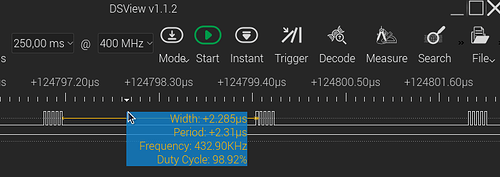

David's code in this posting above
https://forum.arduino.cc/index.php?topic=696421.msg4681554#msg4681554
compiles and flashes, but does not toggle digital pin 8 on my Due.
Changing Blink example sketch tob write to the same pin works (logic analyzer shows signal).
edmundsj's code from initial posting in this thread works on my Due, and shows 47.5ns period (21.05MHz) on my 400Msps logic analyzer. Because of "void loop()" the delay between bursts is longer than 2us. Doing loop with "goto" in setup reduces time between bursts to 117.5ns:

westfw:
Surely the goto is no faster than a while (1) loop...
Logic analyzer says different.
You have seen 117.5ns delay between bursts in previous screenshot with "goto".
Now using edmundj's code with the burst pattern inside loop() results in 2.285us delay (factor 19.4!):
